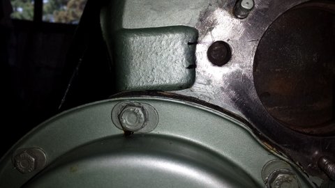

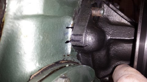

Has anyone come across this problem yet? The small hole on my new water pump doesn't line up with the block hole. It looks like the pump body was cast wrong. See attached pics. There are other clues to bad fit but this is the most worrisome. If I install as is nearly half of the water flow will be cut off.
My old pump was a 1970s aftermarket, if memory serves. Should I try to have that rebuilt or try another new pump?

BoyRacer
I think you are going about this in the wrong way. You can't tell anything by the exterior of the casting. Use the water pump gasket to check the location of the hole in your new pump.

RestoreThemAll
I just used the gasket to check the location of the small hole in the waterpump. All holes line up perfectly on the old pump. The gasket covers up over 1/3 of the hole in the new pump.

Keoke
I give up ... What is the 'small hole' for? Is it the outlet for the bypass hole where the thermostat goes?
I do not know either,.
But Dale just get a new pump and be good to go

RestoreThemAll
The small hole goes back into the block about an inch then takes a 90 degree turn up where it enters the head.
Agreed, order new pump number three. I'll then have four water pumps in the shop. The forth will have to work, right? No ones luck is that bad? :playful:
