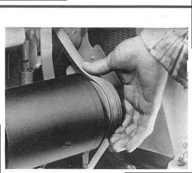

Here is a page from the lucas service manual showing how (not) tight the belt should be. I think most people think it needs to be tighter. Even with an alternator installed, I am surprised how well it works as loose.

Wow. That is loose. Thanx for the thumbnail on this!!
