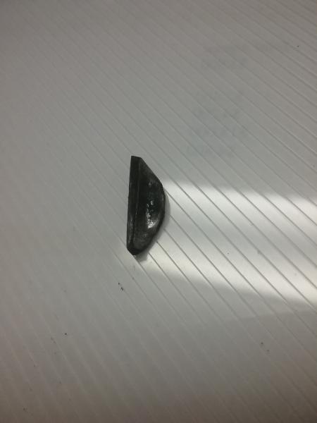

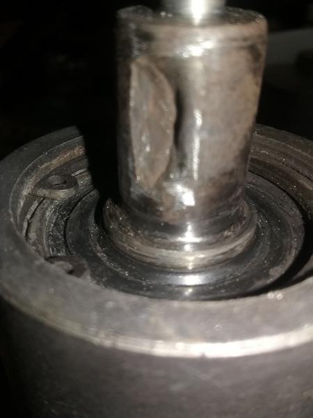

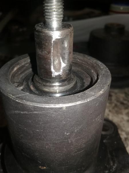

Thought I would post these pics. Going to try to fix the shaft. Any ideas how to get it out. There is a snap ring on the top bearing. Just from looks it looks like it will just press out. Put concerned that there can be a clip inside holding something together. Possibly the outer bearing was put in last. This is the up rated Moss pump.

If I were going to repair it...I’d reweld the entire OD, filling in the keyway. Then machine and grind the shaft as new. Personally I wouldn’t put that much time into a part that is readily available, though

IMO there is a good chance you can just press the shaft back out of the front bearing. The rear bearing may or may not come with it.
But, the force to press the shaft out is going to be applied to the bearing balls. You can support the inner race when assembling, but not when removing. Unless it comes out really easy, I'd consider replacing the bearing as even the slightest damage will lead to early failure (and may not be detectable at the time).
Also wouldn't hurt to measure how far the shaft sticks out now before you take it apart. There certainly should be a clip or shoulder behind the inner race (to positively locate the shaft once the pulley is installed up against the front of the inner race); but you never know. There were some 6 vane pumps long ago where the shaft was just pressed into the races, and could be knocked out of place while installing the pulley. (I think I might have one of those still on the shelf, not certain.)
