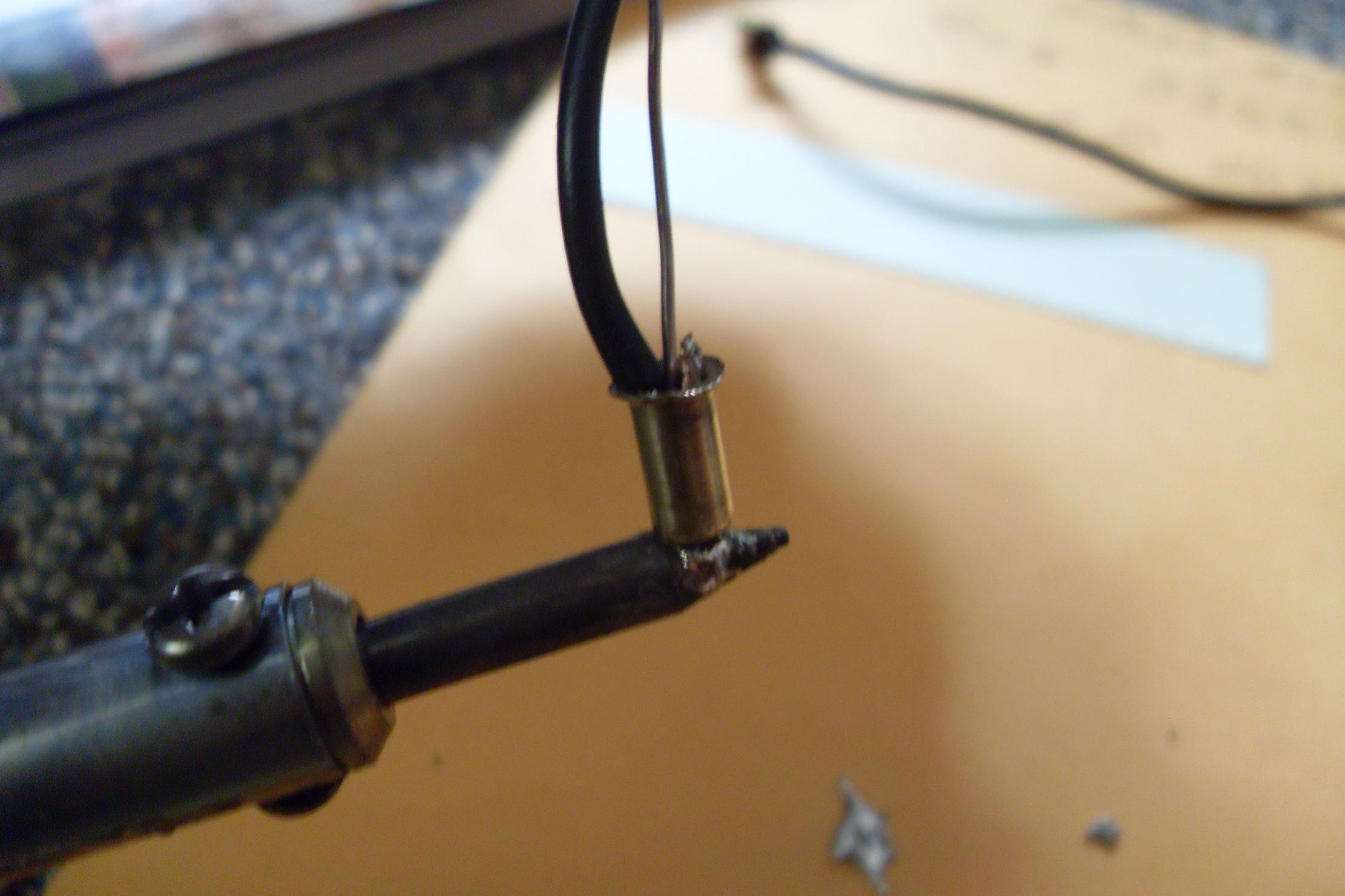

the ground problem has been elusive. All the bullet connections i had gone through and cleaned. before putting my radiator in today i was **** bent on finding what was keeping my signal from getting its full strength. low and behold the turn signal has a bullet connection that plugs on the harness. Mine was plugged in on the pass side... and completely missing on the driver side! well fixed the crap out of that. overkill, whats overkill?
got to cold to keep going but ended the day i put the radiator on dry fitted the new heater valve, stuck a garden hose up the heater hose and blew some crap out. put a reverse switch in and have lights for the first time ever. then started to put my drive shaft in but the metal was sucking the heat out of my fingers so i called it a day.
