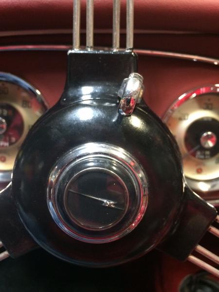

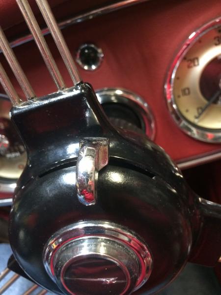

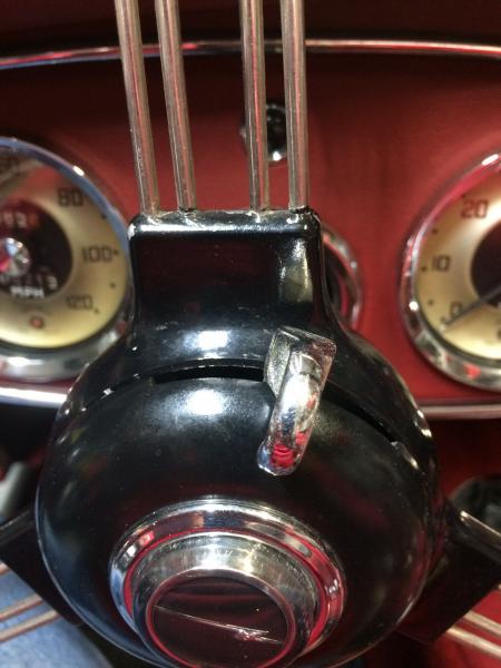

switch 1.jpgswitch 2.jpgswitch 3.jpgI have somehow managed to knock my turn signal (trafficator) in my '60 BT7 off center. Now it does not want to stay on for a left turn. I tried to just twist the switch back into place but no go. Is there a way to fix this without taking the whole thing apart? Where could I find some detailed instructions for fixing this? Thanks...
red57
Loosen the nut & olive on the front of the steering box, turn the trafficator (turn signal switch/horn push) where you want it and re-tighten the nut & olive.
Be prepared for a bit of the steering box oil to seep out. Also, one thing I 'discovered' while doing extensive work on my BN2's box was to leave a bit of a gap--1/32" or a bit more--between the trafficator 'dome' and the steering wheel hub. If you place the trafficator against the hub the hub will likely rub the trafficator when you turn.
MikeAH100M
I also found it helpful to have a second person hold the trafficator/horn assembly in place while you re-tighten the nut on the steering box. It keeps it from twisting with the torque.

Ha! I didn't realize once I just crawled under bumper there's plenty of room to reach up to the nut. This thread fixed my problem as I too was able to readjust my trafficator! Sweet. Thanks.
