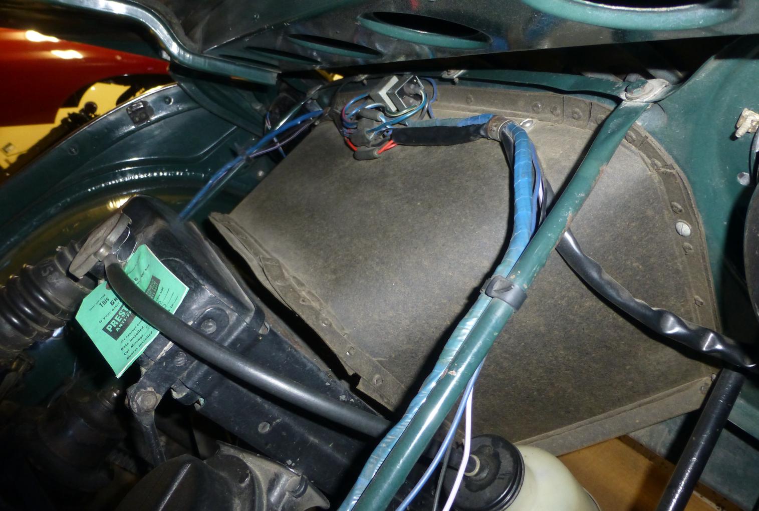

I am finally getting around to placing a new Moss radiator duct on my car. Its the fiberboard type with a grain vinyl underside. The problem is the from edge of the duct is straight across yet the valence it mates to has a slight "v" shape. So, the darn thing doesnt fit unless I do some srious trimming/bending to the fiberboard. Any suggestions?
How mine fit (came from Moss, though it is a TR4):
For the curious... that business on the top are the headlamp relays.
