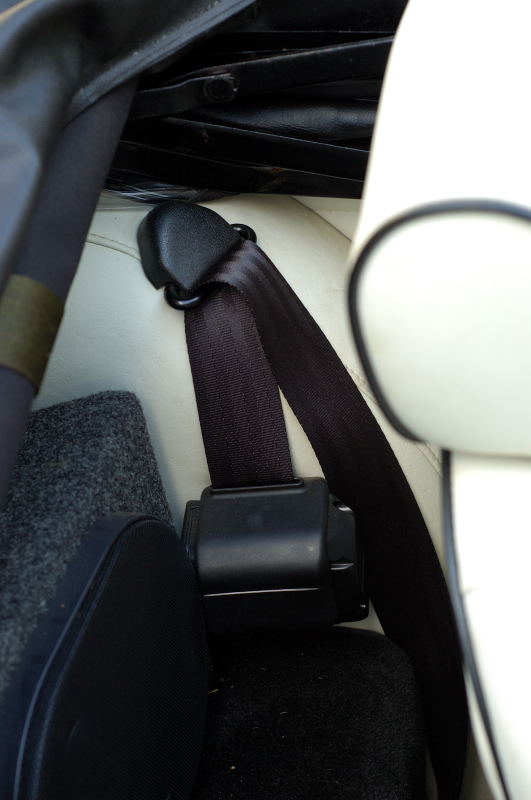

Adrio,
Here's a couple from my TR6. It was like this when I got it, so I can't comment on the details of the installation itself, but it seems to work, and passed the NY state inspection...
Picture 1

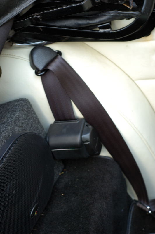

And #2
Apols for the image quality - It took me a while to get them small enough to attach, I shoot raw usually. If you need a better image, or a different angle, PM me and I'll try to help.
Alan
