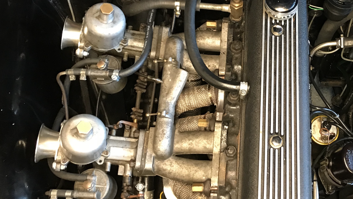

I saw a picture today of a TR3 motor with Stromberg carbs and the long runner 4A intake manifold. There was a hose coming off the center junction of the manifold that ran over to the right side of he motor but I could not make out what it was connected to? What is it's purpose? :unsure:
CJD
Probably a positive crankcase ventilation valve. The later TR4 had to stop using the TR3 road draft tube to meet emissions standards.

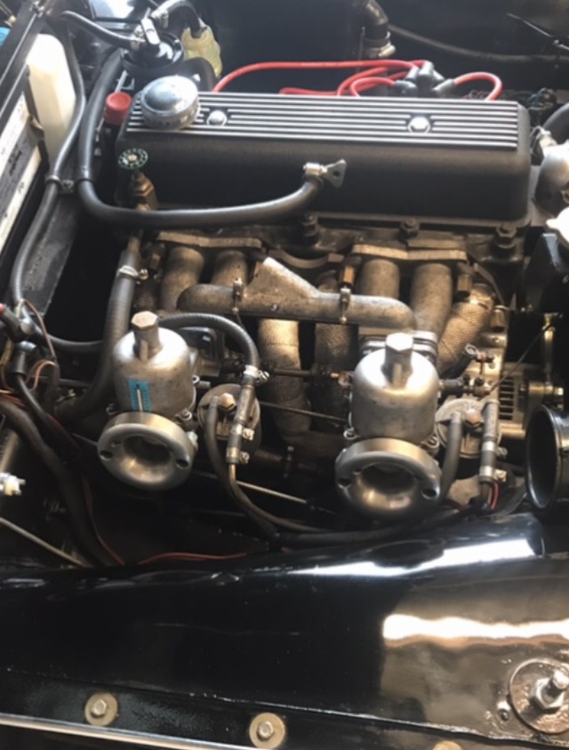

Karl
I ran the later inlet manifold and the longer H6 carbs with short intake trumpets and they fitted
I do have the harder engine mounts that stop excessive engine rocking.

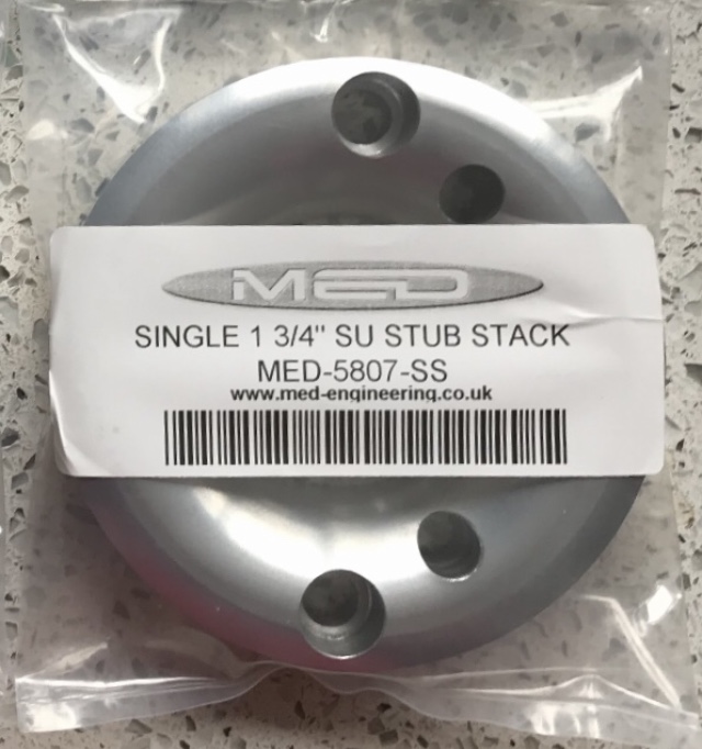

i later upgraded to full radius intakes on the carbs.
worked well for me

What confused me was in the picture I saw he had the hose coming out of the intake manifold center passage (some of them...not sure wether 4 or 4A they have an outlet on the center piece that connects the two halves of the manifold together) If it was for blow by as John suggested why would he not have the hose coming out of the valve cover instead of the intake manifold??? Wish I could post a pic.

its either the PCV valve cover breather system that “sucks” the valve cover vapours into the intake manifold to be burnt. As CJD says.
see borrowed picture
or
its a vacuum pipe to make a brake servo work. That you can see in Billspohn picture .

I see what you are saying. Just looking at the photo of the way your car is set up.....picture the hose coming off "your" intake manifold and looping over the valve cover and down to the ground?
