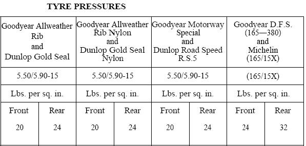

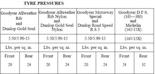

Although Piggott doesn't mention it, I believe late (some time after 1959) TR3A were available with 165/15 Michelin X radials.
