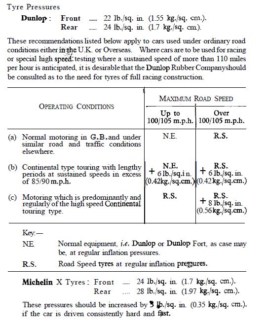

There is a table at page 23 of Practical Hints for the Maintenance of the triumph TR3. This is the Owners Manual and can be found on Google (and I think Randall Young -TR3 Driver- posted it on this forum)

Owners manual says for Dunlop tyres (assume these are bias ply) Front 22 psi and rear 24 psi.
For Michelin X tyres 24 psi front and 28 psi rear. Increase by 5 psi if car is driven consistently hard and fast.

Well the books call for this or that but that was in the 50's-60's-70's Todays tires have a rating that should be a starting point and that is a cold tire. Because of the foot print the high end number of the tire rating would be best but you may find it to be a hard ride. If you drive solo about town not a big deal. Summer with two people and luggage and highway speed add a pound or two to not over heat tire. Your spare should have the top pressure and tires over six years old come into question also. Todays tires come with not only the size but speed rating and date it was made and a DOT strip these are the factors of todays tires. And your life is on them. At a SCCA event I saw a driver say drop a 1/2 pond here and add a pound to the left side there that is fine tuning and you will need to do the same. Madflyer
Sarastro
Modern tires generally take higher pressures than the old cross-bias and even older radials. Dunno why that is, but it is generally true, based on recommended pressures listed in owners' manuals. So, the numbers in the TR manual don't mean very much. This is just one of those things you'll have to experiment with, but the responses above should give you guidance on where to start.
