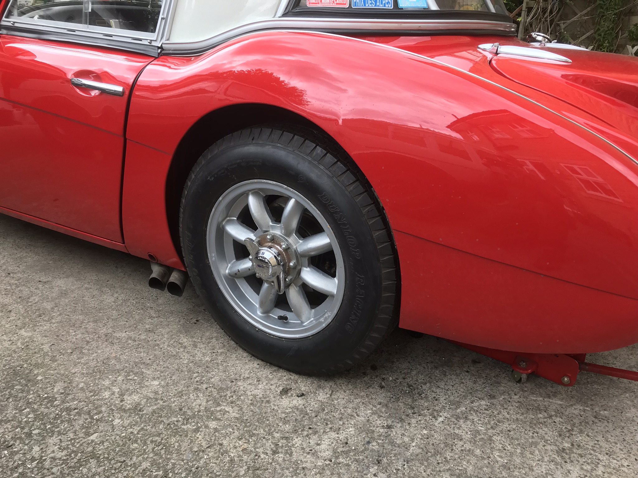

Work continues on my Tri Carb. I will be installing Minilites on the car for the rally look and will probably go with the 5.5” width.
I'm thinking 195/65 tire size. I had 185/65 on my BJ8s with Dayton 5.5” wires.
Could I go to 205/65 or would I have rubbing issues at full steering lock? I have lowered the car 1” front and rear with lowering kits from AutoFarm/AH4H.

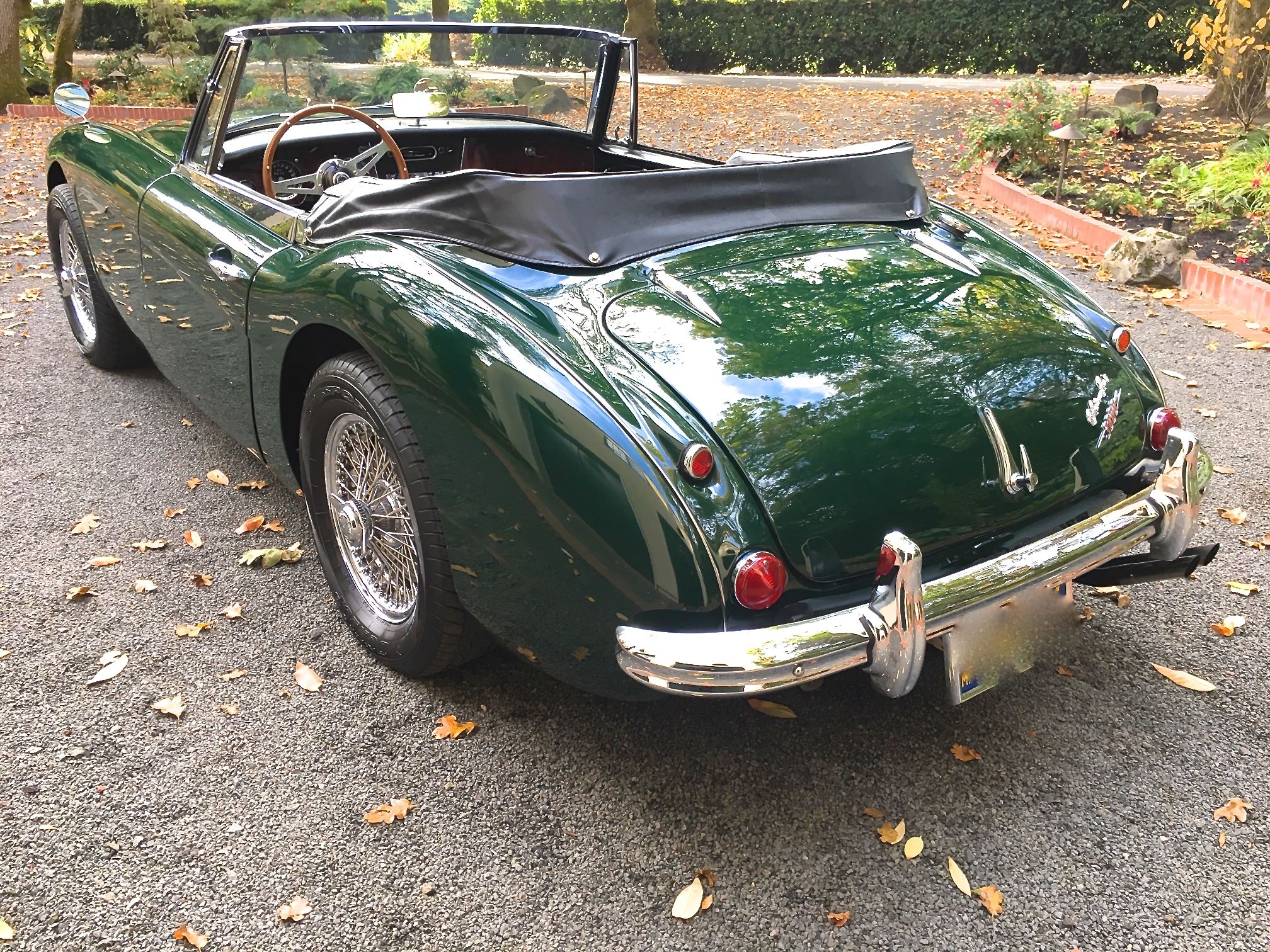

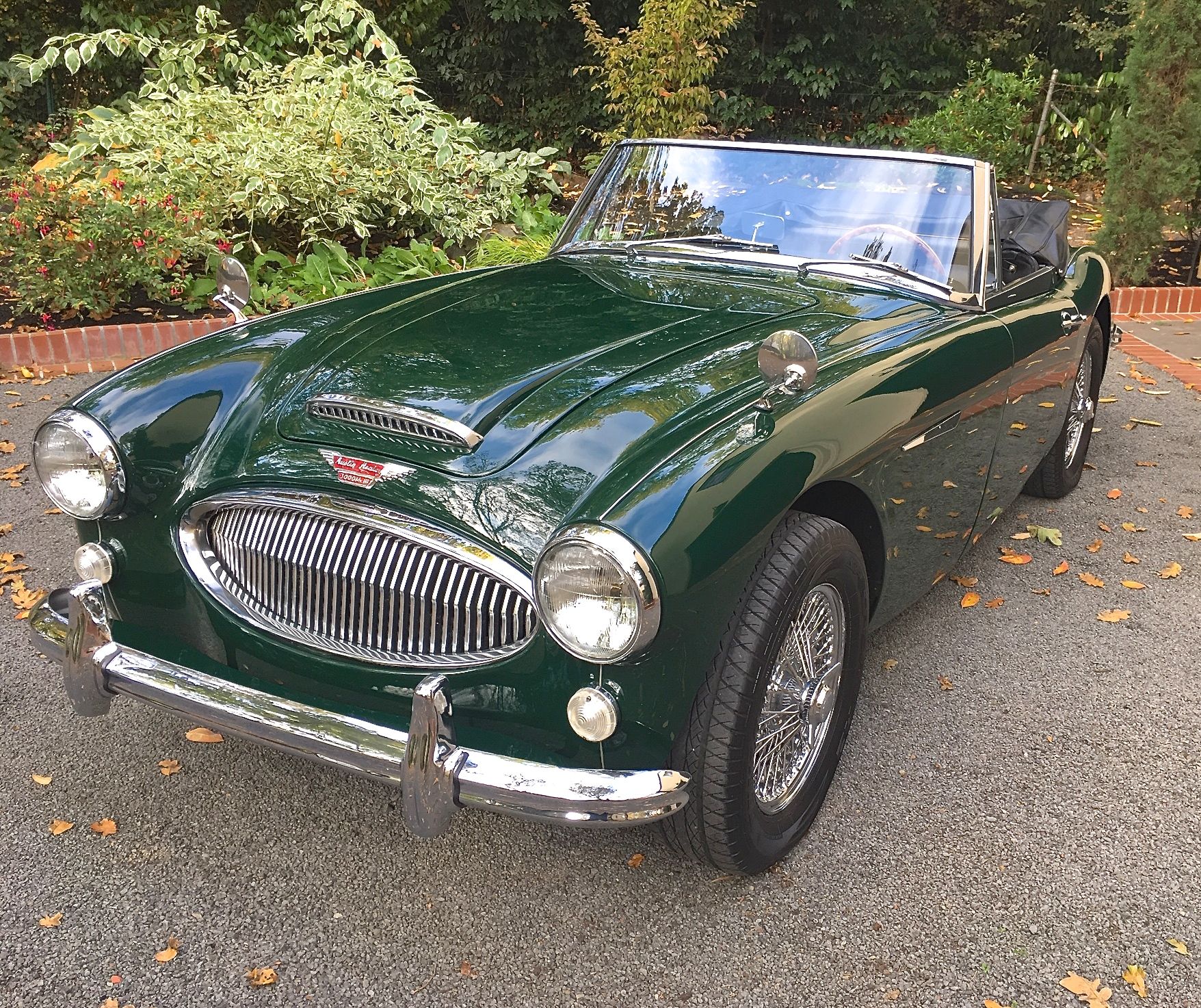

I run 205's on my '65 BJ8, stock ride height. A little inner rubbing in the rear during hard corning which could be solve with a spacer.

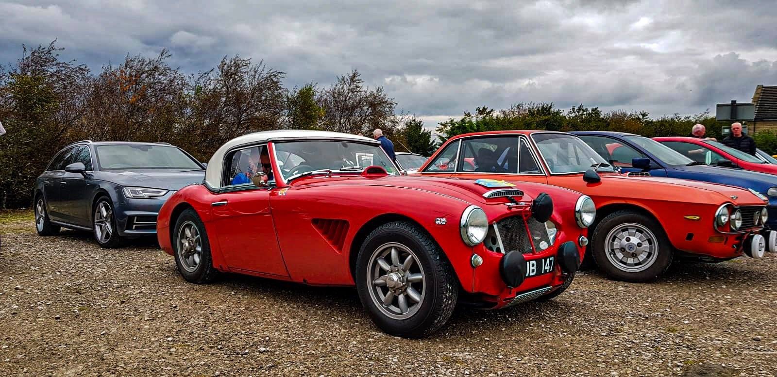

If going for the rally look unless a tarmac racer you don’t want wide tyres, 185/65 15 on 5.5 minilight look alikes should look good.
