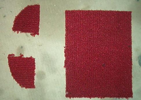

OK I know there are a few here who have installed Stock Carpet kits.
I have managed to test fit every piece except three.
1. is a rectangular piece maybe 8 X 10 inches - I presume this is a spare?
2. Two pieces that are quarter circles - about 3 - 3 1/2 inches up each side.
where do these go?
pics would help - as would pics around the wheel humps
thanks

None of the above - here
I just put in a kit that pretty much matches Silent Unicorn's diagram above. I did have a half circle piece with a slit almost all the way through it. Almost like it was meant to be pulled apart. If it was, the pieces would look just like the ones in your pic..... I used them to cover the seams at the base of the wheel wells. I'll try to remember to post a pic as soon as it stops raining and I can uncover the car.
i had nothing like those when i did mine..
m
JP -
I used the kit. Frankly, I did not use the "pizza shaped" pieces. They appear to cover a small area around the wheel arch. As for the larger piece --could it be for the vertical area between the foot wells? I don't recongnize it.

thanks George - I wondered if that was where. Any advice on installation order? I'm actually contemplating making the tranny piece removeable

Hi JP:
On mine I did carpets first so that trim panels fit against them properly and I could check as I went along. I glued down the rear section of the carpet that covers the tunnel only from the shifter back.
The front part is snapped into place using snaps (that come with a carpet kit). Male fitting screwed into body, female fitting attached to carpet low near the floor located at the front corners of this carpet piece. If you have a console that also holds the carpet in place due to the tight fit.
You need to peel back that carpet to check tranny fluid level and to remove the tranny mounting bolts or shifter (shift boot terminates under the carpet) or to remove emergency brake assy. And we all know how often the tranny in a spridget gets to see the light of day. I've come to the conclusion that you almost have to pull the motor/tranny on these cars just to change the radio station, ok thats going a bit far, but not very!
