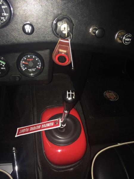

in my case I followed the instruction on cutting down and offsetting the Datsun sifter and marrying the stock one .
mine fits perfect with surround boot and shifts perfect with no modifications to the boot.
heres the shifter in neutral on my car.

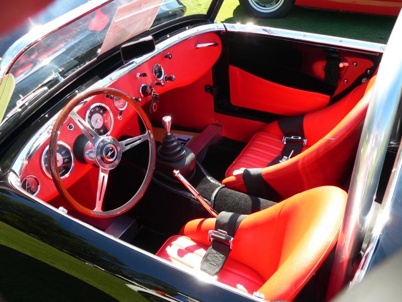

Totally doable if you want stock look as I did.

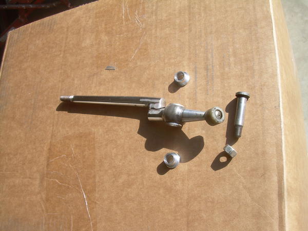

I agree with everyone above- when you are welding it back together the total length of the shifter should be 7 to 8" long.
There are many different shifters that go into the 210 trans and they all start out different lengths (I have had MANY of them) but they all need to be cut down to about 8" long for the Spridget, both Bugeye and later need the same length.

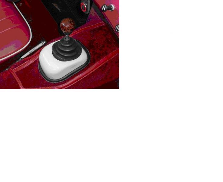

Bill Loeb had the actual shifter surround can shortened by about 1" which lowered the rubber gater and made everything work much better. He will probably post a picture here soon
