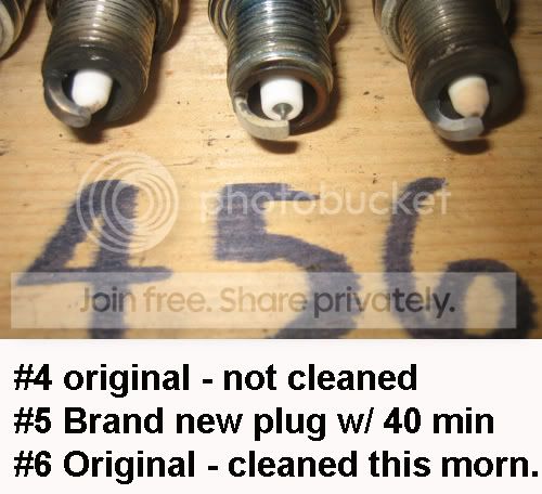

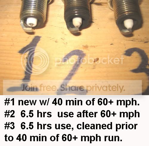

Here's my plugs before and after about 40 minutes of high
speed driving, only two toll both stops and exit ramp on/off to Bikers Bar,
To the non-mechanic guy, my new plugs look a bit lean.
I am totally stunned the black plugs turned white????

First question, why are #1 & #5 different on the tips than the others? Are you mixing brands?
Second, but a suggestion. I'd go two flats back rich and call it a day.
Just curious, did your engine run any hotter than before during these 40 mile runs AFTER the leaning process?

Unless you find other indications the engine is running lean, I'd leave the mixture alone and read again after 1000 miles or so. That nice tan color you see in the plug charts comes from running leaded fuel; modern fuel takes a lot longer to leave permanent deposits.
The cleanup of the sooty plugs is exactly the way it's supposed to work; the insulator is supposed to get hot enough to burn off the soot.

No! And Frank A was kind enough to tell me to watch
the temp gauge. A constant 160* the entire run.
Two flats back into rich it is.
thanks all.
