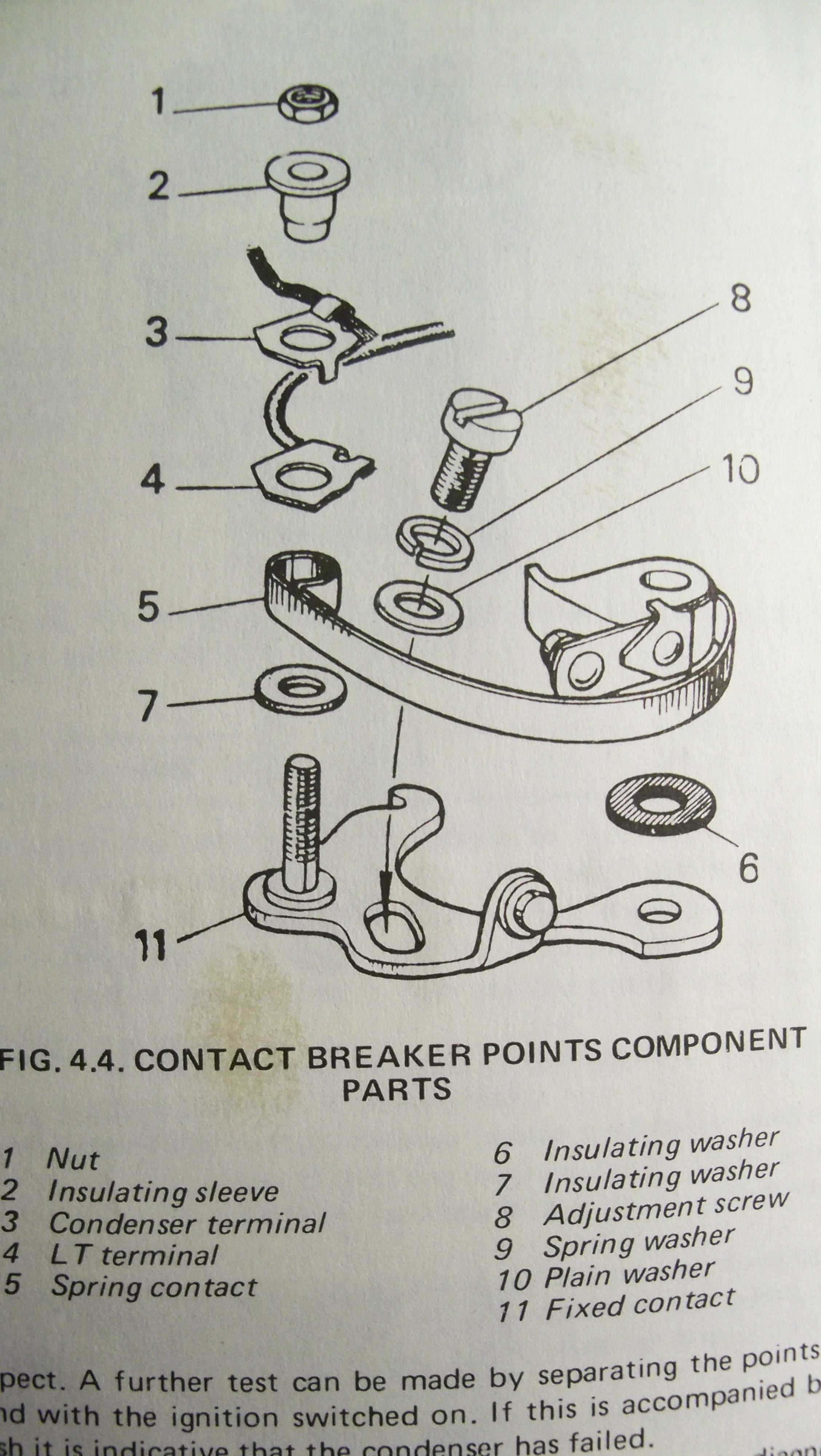

You said you replaced the condenser; did you replace the points as well? Check to be sure the mounting post on the points is insulated properly. There should be a couple of nylon spacers to keep the points separated from ground. And make sure the ground wire inside (part #5 here - > Ignition/Distributor - Ignition - Electrical & Ignition - Triumph TR2, 3, 4 | Moss Motors < - is in good shape as well.

I did replace the points and did not see the nylon spacers, I'll go back to the pack and see if I missed those. Thanks!
poolboy
Here's how it goes :
