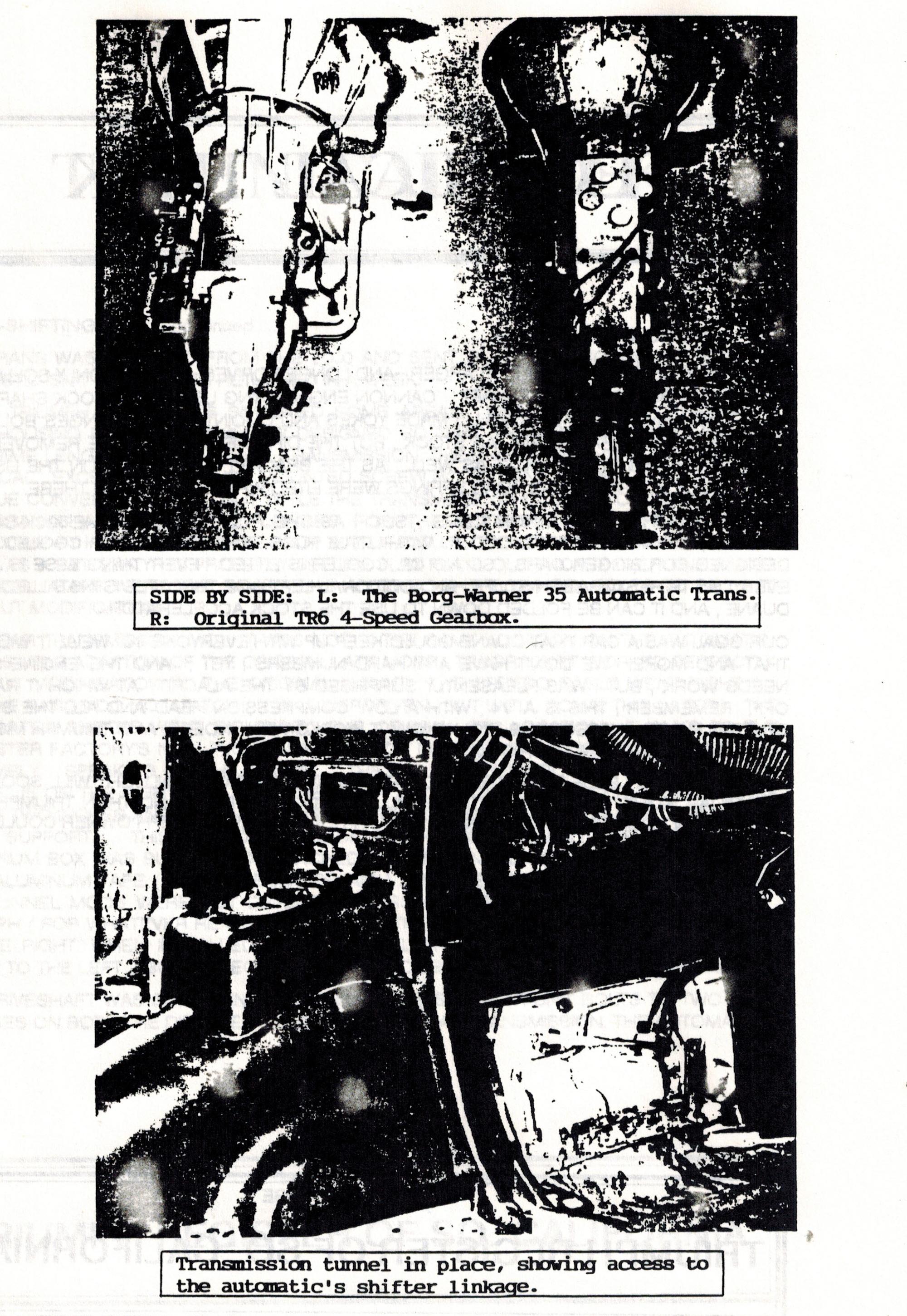

The memory was strong enough that I was sure I had read it somewhere so went looking...
It was a 1990 TRSC article reprinted in Volume 2 of TRSC's Technical Talk.
A transmission from a Triumph 2000 was used (Borg Warner model 35). Some modifications were needed of course, but the bell housing seems to have been compatible.
Dan - if you want a copy of the article PM me your email address. It isn't great detail (only 3 pages) but does highlight what had to be done.
Geo Hahn
Okay - simpler to post it for all to see. Note this may be copyrighted material though it is from 30 years ago and a club that may have merged into something else along the way. I'll delete if anyone sees a problem.

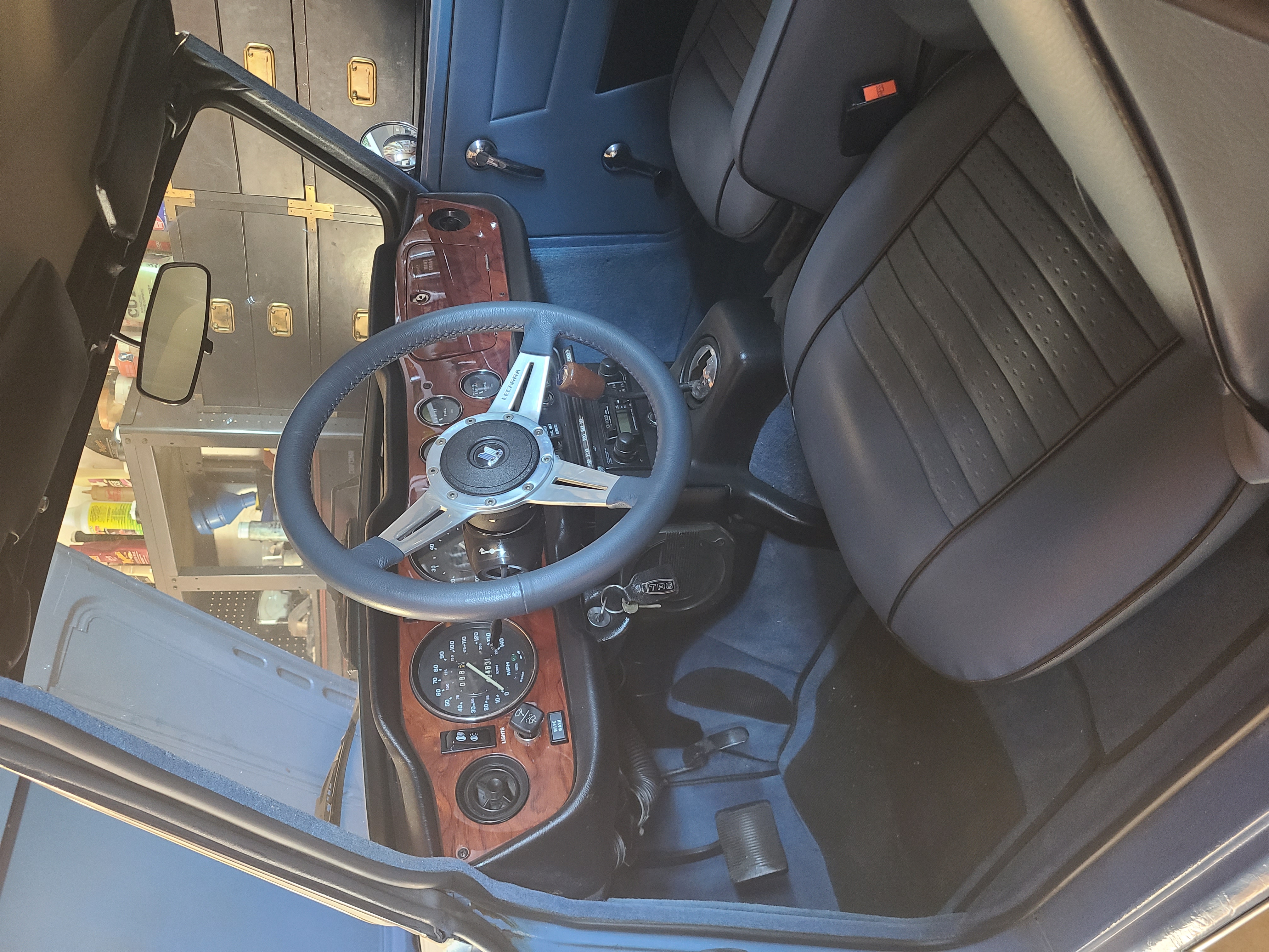

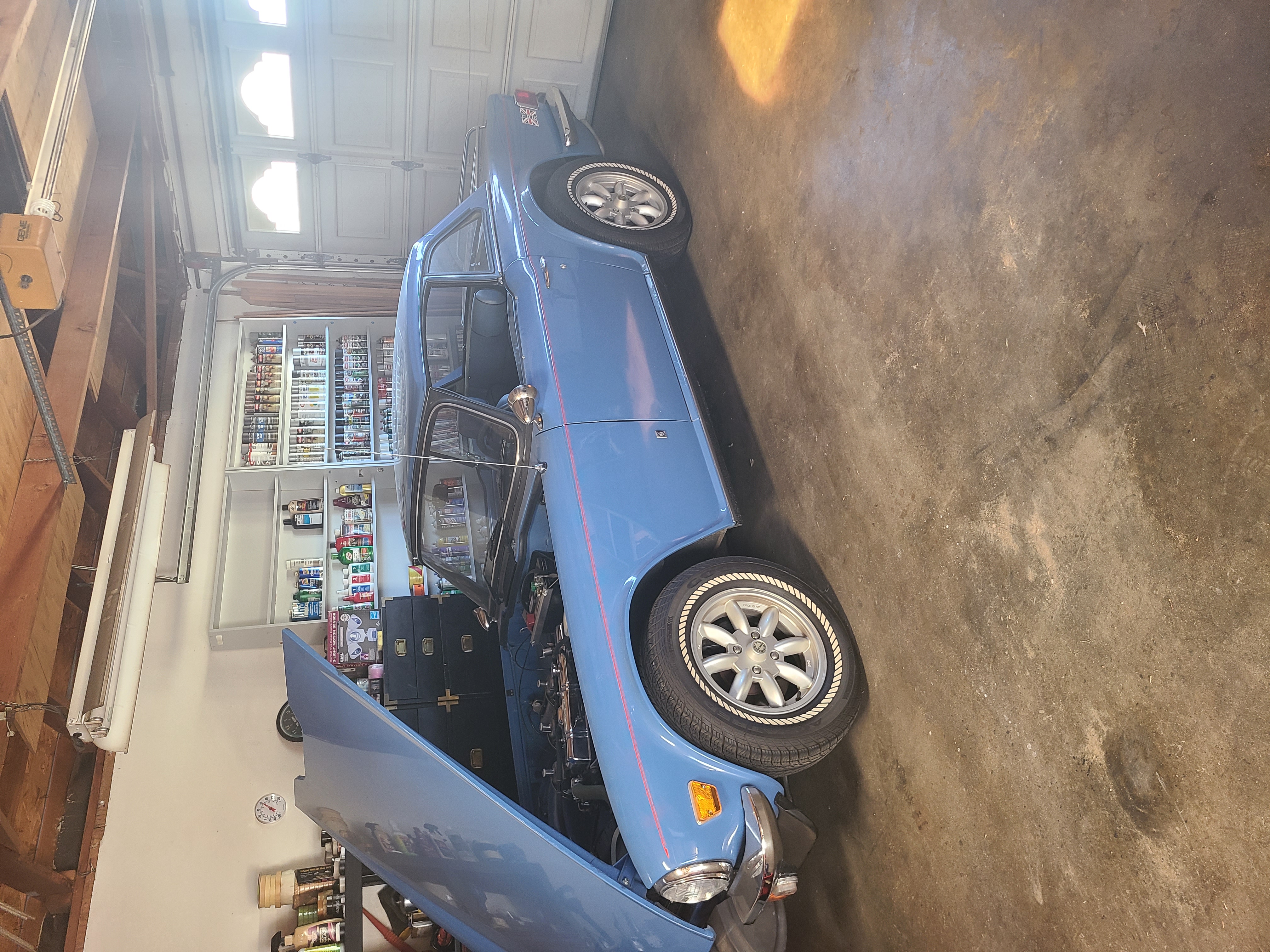

philstr6
Heres the car that Steve build for his dad and then my dad bought it awhile back.i will look for pictures of the trannie borg warner automatic
Philstr6
