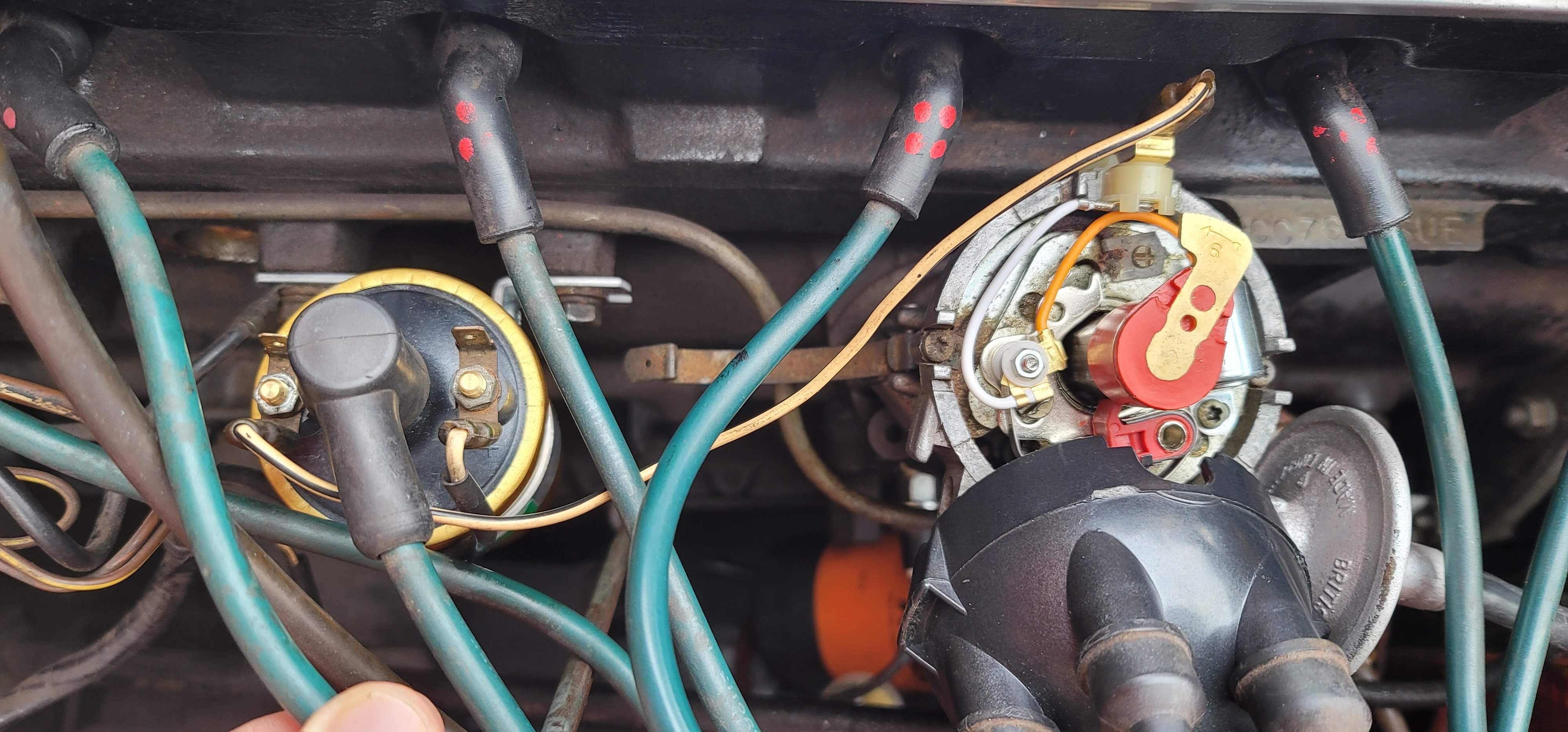

To continue from a previous post, but more description subject line... Car started fine, then just died. Got a spark tester.. no spark. Changed points, rotor arm and condenser, installed new Lucas sports coil. Even removed the distributor and cleaned it up. Still no spark. Not sure if I need to do timing, but no matter what I still should have spark, correct? I don't know what else to do other than check voltages but I'm not sure how to do that. Any advice would be appreciated!

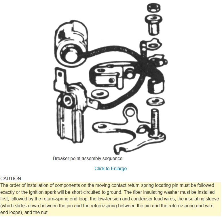

I am not trying to impugn your wrenching skills but I have seen this happen even with people that know what they are doing if they get in a hurry. Is it possible that you have the stack sequence wrong for the low tension and condenser lead wires? We used to see a car or two come in on the hook after a home tune up with the result being no spark. First thing we would check would be that stack up sequence. It is something not discussed in the factory/Bentley manuals nor in the BMC/BMH/BL manuals for MGs either. Even the likes of Mitchell and Chilton did not have this information in the manual until 1972. See attached shot from a 1972 Chilton manual. Note that the fiber washer and spacer were switched to plastic in the early to mid seventies by Lucas.

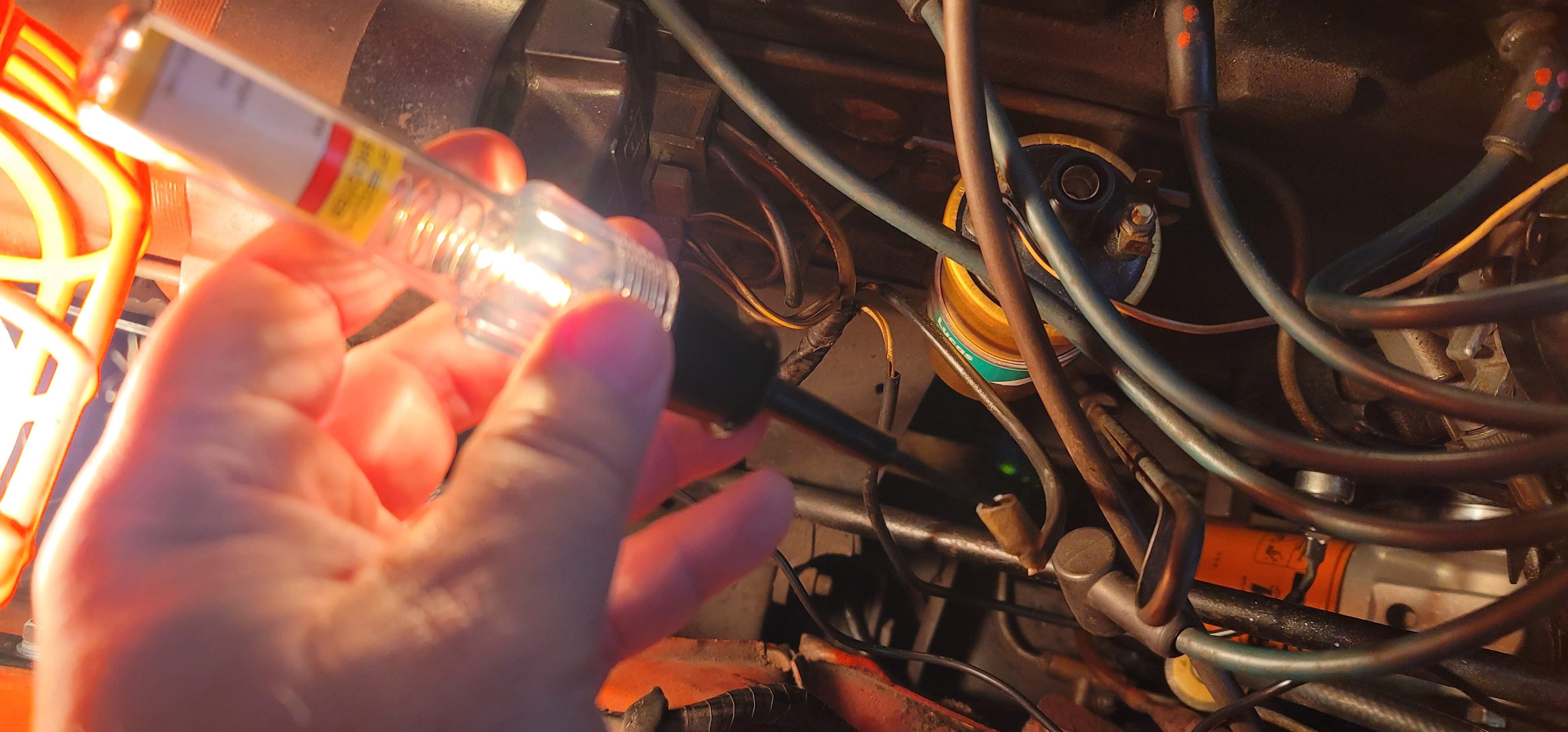

I got a voltage tester. Clip to the negative battery post. Tip to the positive on the coil. Lights up indicating power! Also lights up if I touch the lead on the distributor indicating the wire from the coil to the distributor is ok. Now what?

It's hard to tell from the pic but I don't see any "wear pattern" on top of the rotor coming from the carbon button inside the distributor cap.
Look inside the top of the cap to insure the black carbon contact button is in place.

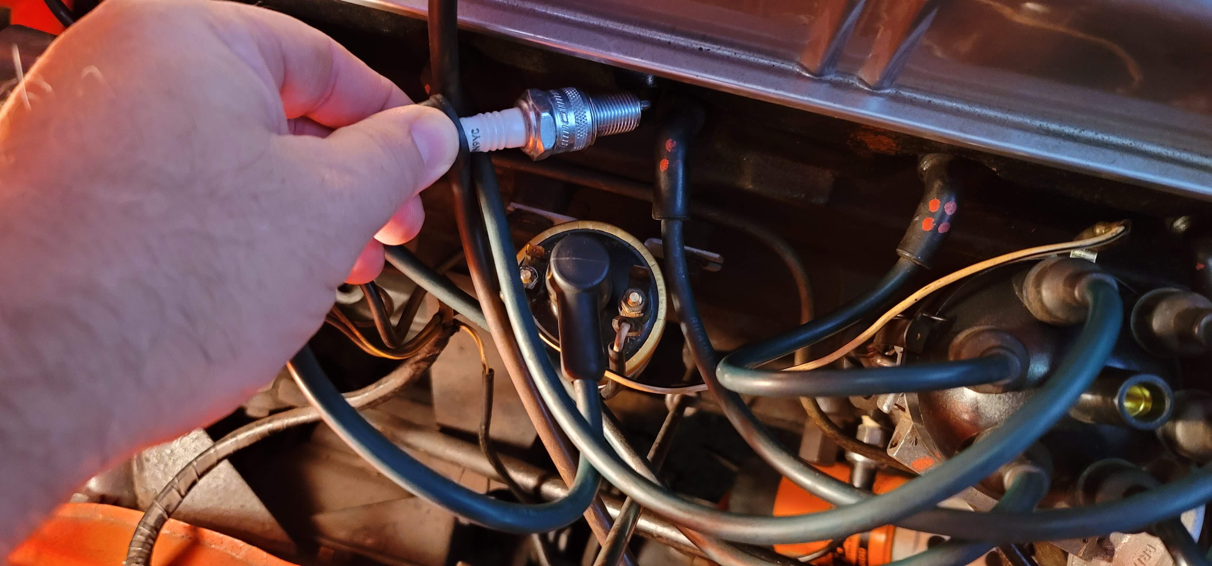

Thanks for everyone's tips. I was able to finally try the spark plug test..... no spark, yet there is power to the coil. I pulled the wire from the distributor that goes to the coil, inserted the spark plug, grounded it by touching the block and started the car (see photo). I even tried another distributor wire to make sure it wasn't the wire. I also tested the power points with the spark tester and still getting power. Even inserted the tester into the wire going to the positive end on the coil and it has power too (see photo). First, am I doing the spark plug test right? If so, what's next for me?
