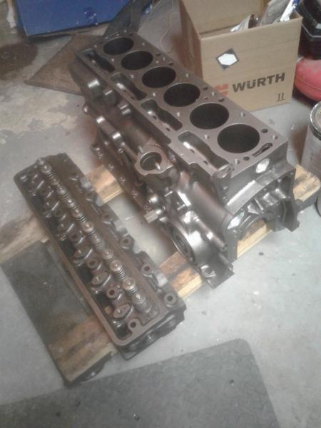

Got my block and head back Wednesday. love all that fresh bare machined metal. Heads rebuilt. Shaved, new harden valves seats and checked for cracks and leakage. Block boiled, baked and shot peened. Plan on painting Saturday with POR high temp block paint. Read articles where painting the inside of the block was beneficial for oil drainage. I'm more worried about rust building up more then anything. Any ideas?

I've never painted inside. I've never had any bad effects from oil and the coolant should have rust inhibitors. I'd worry more about the paint coming off inside.

Is that not what polishing and porting is? I would not use paint because like Tom suggested it will come loose and gum and clog everything. Unless you have a lot of faith in POR15 and that stuff does stick. When I was in high school auto shop, there was talk of chrome plating the inside of heads and blocks to make the fluids flow better, but I think fuel injection cured that on the heads.

We used Glyptal in the valleys under the intake manifolds in V8 race engines after polishing the block internally to let the oil drain a little easier. I see no need to use it or any coating on any of these old inline engines, it's just a waste of time and money. Sorry, others might feel differently, I don't!
Saying that, polishing the inside of the block does relieve most stress areas in high performance engines, but they don't need to be coated, oil does that job very well. PJ
I was trying to recall where I read that. May have been in the TR6 Performance Preparation Manual. What I read was exactly what Paul said. Didn't remember if my block was coated inside before it was stripped but do remember working on many others over the years that had a black gloss coat of something inside. Assumed it was engine paint.

Those 2 You Tube videos were very informative. I guess no real benefit to doing it to our engines.
I agree about no internal coating. Have read about the Glyptal as well, and think I have rebuilt at least one motor that was coated with it. Apparently it has been used in many rebuilds and is an accepted practice, but it sounds to me like just another opportunity for failure if it comes off and clogs an oil line. Have no idea what the proper prep is. Get the block as clean as possible I suppose.
I would not worry about the internals of the car rusting unless you are going to let it sit without driving it for a very long time, like longer than just the winter.
Used mostly in race and high horsepower engines. Does not really prevent rust, oil does that. Just makes the oil drain to the pan quicker in race engines and dry sump engines.

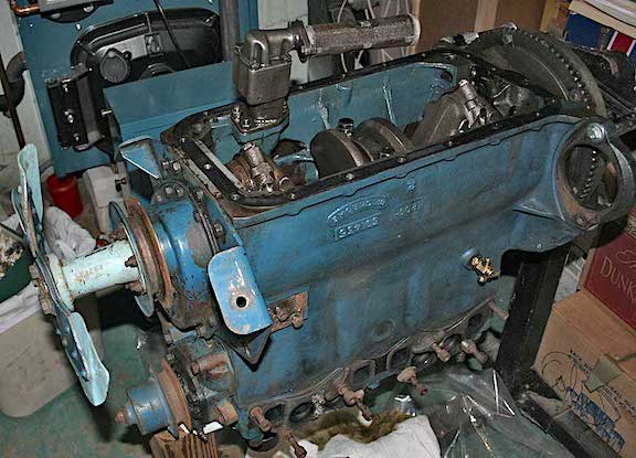

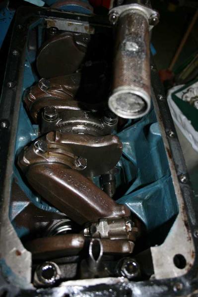

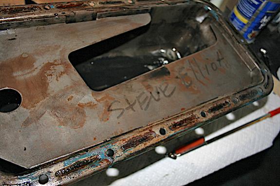

I bought my 61 TR3 as a project with not to much history...I have done a frame off/rotisserie restoration. When I was making a decision about rebuilding the motor I opened it up to check the vitals, to my surprise the inside of the block was painted, the car is just about finished now and the motor runs perfectly. The baffle plate in the motor was signed by I presume the engine builder, Steve Elliot.The car came from the North West, anybody know the builder?
Some photos attached.

Not just painted...you have a windage tray too. Very neat!
The idea behind painting the inside of the block is to both aid oil drainage and to lock in any scale or casting sand that may break loose later. I would rate it as...once you have hot rodded everything else you can think of, you might as well paint the block.

Thanks for the information on Elliot, by any chance do you know the location of his shop?Would like to find out more about my motor. He actually signed the back of the speedometer, I guess when the motor was done.
