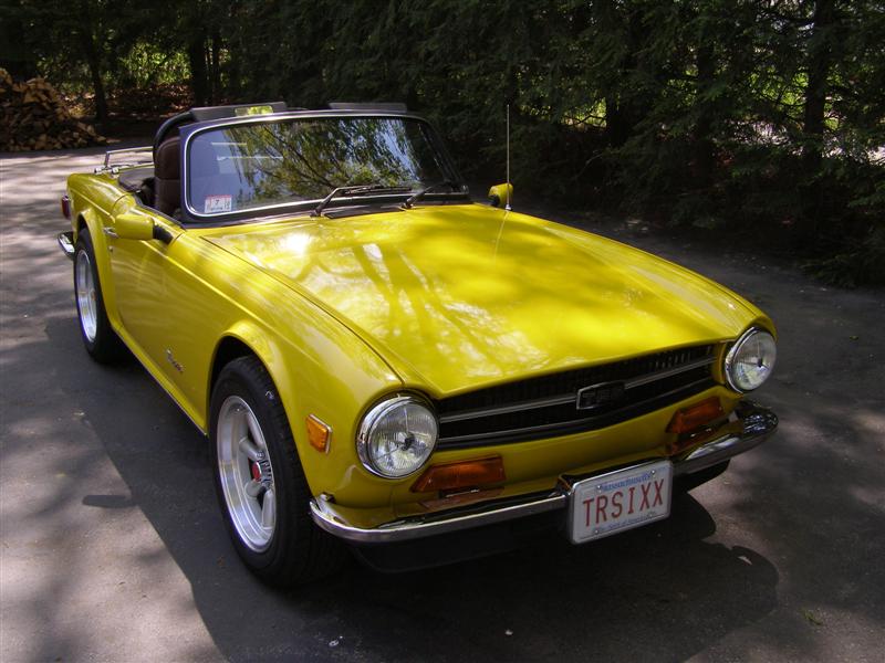

I have a set in my car and I like them very much. A lot better than the stock lamps, but I can't say if they are any better than some of the new high end bulbs that are available.

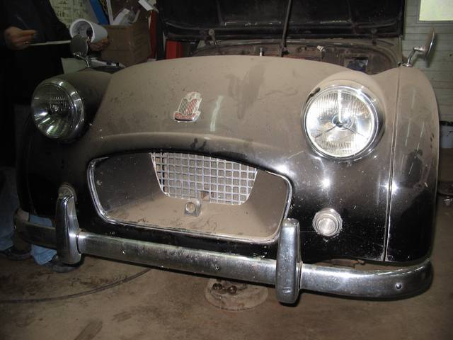

Here is a TR2 owned by the original owner here in the Montreal area showing the correct small dot and the word Lucas across the dot.

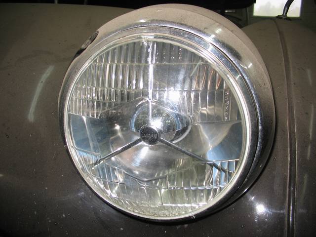

Here is a closer shot of the early small-dot Lucas 7" diameter lamp. The Comm. No. on this TR2 is about TS 6000 L.
Andrew Mace
Don, those "earlier" lamps are known as "P700" and took a more typical (for the time) headlamp bulb. Original "PL700" with the PL shield rather than the round LUCAS center) took a Type A headlamp bulb.
For whatever it's worth, PL700 lamps are not shown in my Lucas Master Catalogue 1945-60, but the P700 lamps are shown. Also, if you look at any number of factory publicity photos of TR2, TR3 and early TR4, it is the P700 as pictured above that you see.
Finally, even originals weren't always the best. I bought some NOS P700s back in the mid-1970s (I worked briefly in an ex-Bap-Geon store, and -- honest to goodness, there was a pallet full of NOS P700s!). Optically, they were fine, but some of the tri-pod bars weren't aligned very well inside!
