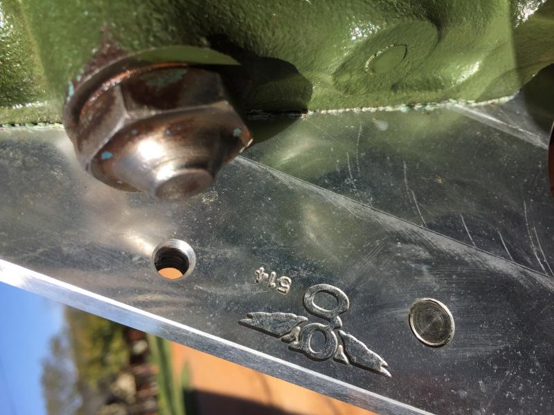

Rut
Gerard,
No lecture intended or given, just an observation about our cars. I'll be at the beach for awhile and I'll check out the serial number on the adapter plate I say I have when I return home...what's up with that?
Rut "Obi Wan" on the road
Rut
Just to complete the circle.Rut
