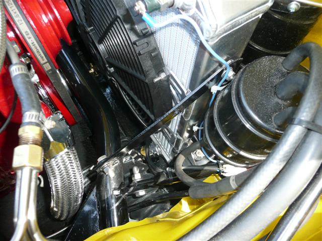

I do have a little room in there. Not much, but a little.
I have the Perma Cool 16" fan pulling also. It fits just fine without moving the radiator. You do have to locate the fan so that the deepest point of the motor is just below the cross member. The fan covers the radiator very well and as the others have pointed out, operates flawlessly. It also pulls a lot of air. You drill small holes in the radiator frame for self tapping metal fasteners to mount the fan. Very cool. You don't want little kids and small dogs crossing the street in front of you when this fan kicks in. WOOSH. You will have to scrape them off the grill.
The difference Paul between mine and yours is you have factory brackets welded to your frame, which causes a wee bit of room sacrifice. I have my fan mounted onto the fins of the radiator and have brackets over them, sorta reverse of yours. This gives me about an extra quarter inch.
Yes, Bill, I can see how it would. These are very close to the radiator core, but there is a tiny gap in between, probably closer to 1/8" with the flat head bolt that comes through the bracket.
