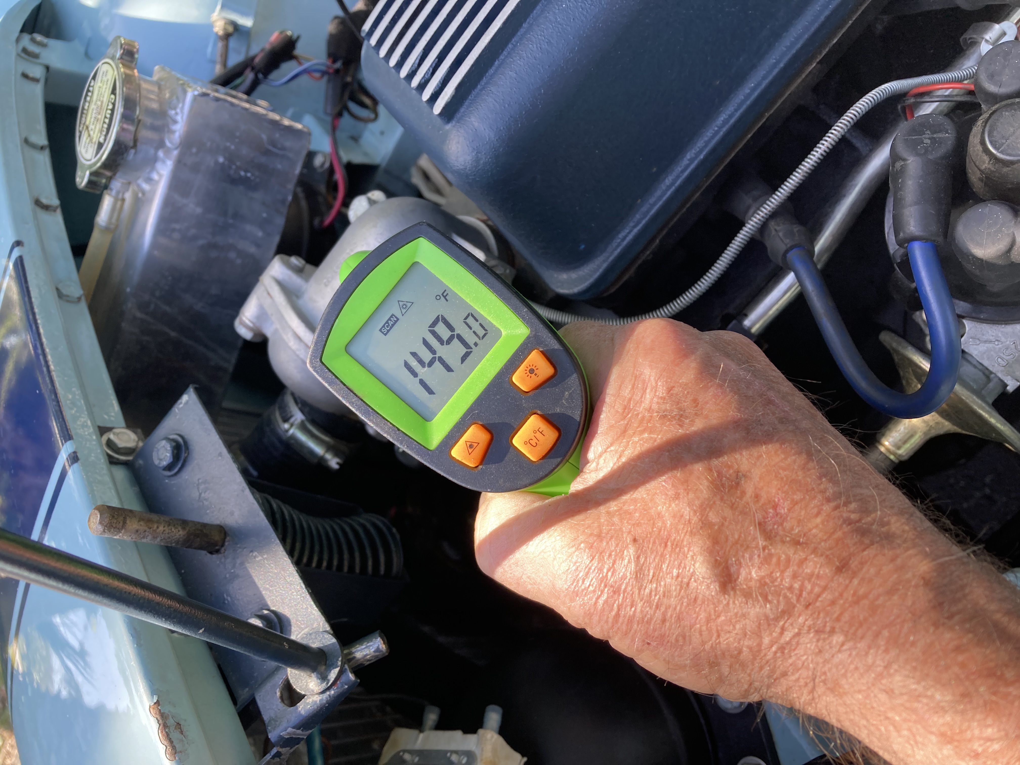

When hot, I have pulled over, popped the bonnet and using an infrared heat gun pointed directly at the thermostat housing I get a reading close to 175-180. Pointing at the rad I get 170-175. Pointing at the water pump housing I see 175-180.

So, how accurate do you think the heat gun is? In all honesty, I can tell a hot motor when I am around one...and when this gauge is reading over 200 degrees and I pop the bonnet I sense it is lower than that. My heat gun seems to confirm my thoughts. When aiming at the thermostat housing where the temp bulb is screwed in, should I expect the temperature of the gauge and my infrared heat gun to be the same? Would that also be a good way of adjusting the gauge? By going by the reading of the gun?

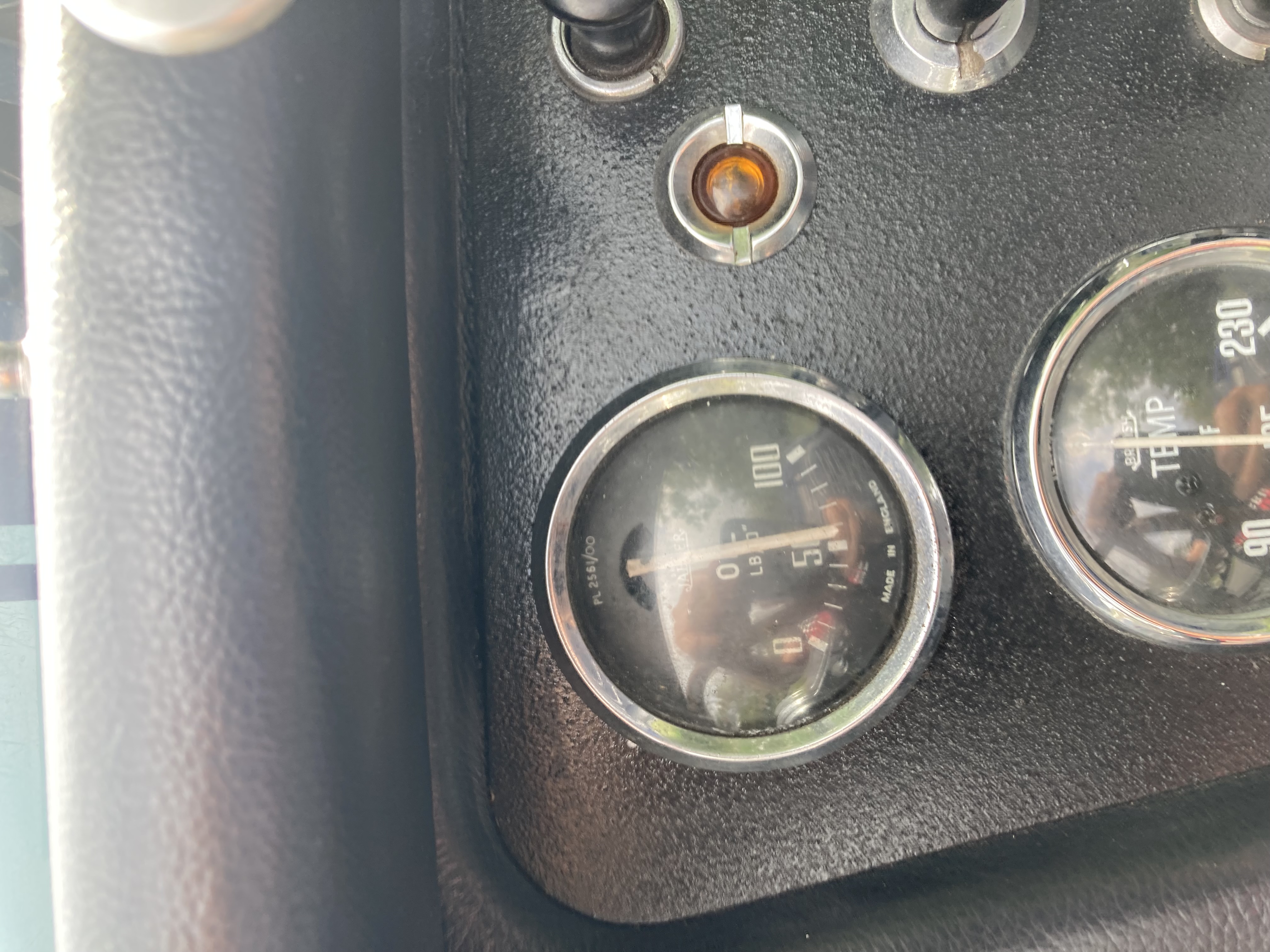

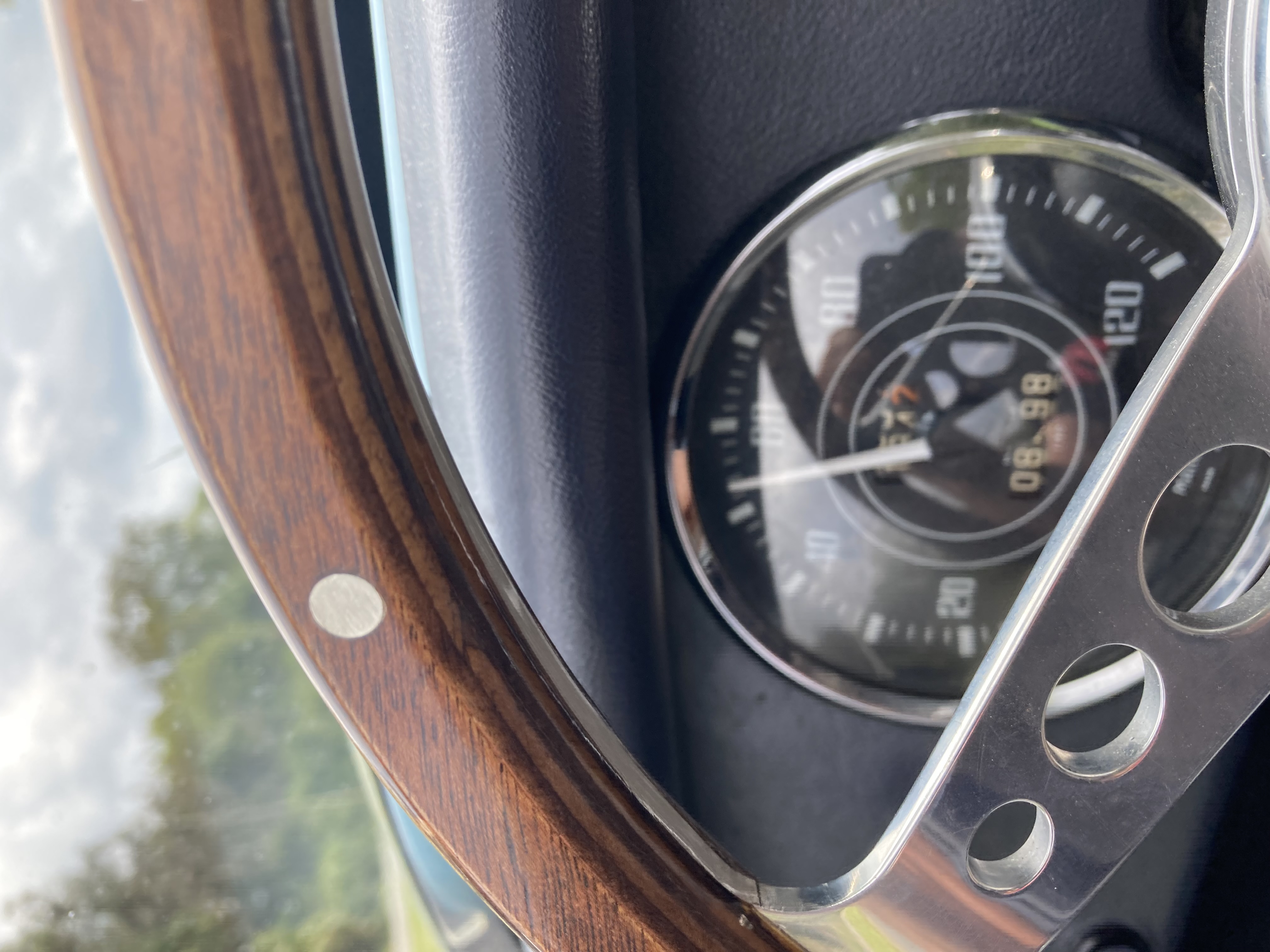

Done!
Went by the detailed post; thanks CJD....the gauge is cheap and made in China with a Made in England sticker on the face of the dial...
smiling smiley
Brought out a cup of boiling water, dunked the bulb into it and made a mark on the dial face where the trim ring goes. Using some needlenose pliers I was able to manipulate the needle down a little to the mark.
Here are before and after....the after gauge reading doesnt show that well as I was driving and couldnt get the phone farther away, but you can see it is vertical, the needle falling a little below the 185 degree mark...it is currently pretty warm here today, about 83 degrees out..
Once back home I let it idle for quite a while....the fan was on the whole time and the gauge is reading about 180 degrees.
Sorry about the pics...they loaded fine on another forum, not sure why they all flipped over??

So, how accurate do you think the heat gun is? ... When aiming at the thermostat housing where the temp bulb is screwed in, should I expect the temperature of the gauge and my infrared heat gun to be the same?
FWIW (since you've already fixed the issue, yay you!)
The metal of the housing will insulate the heat somewhat, but OTOH after a long drive it will have heat-soaked to the point where it should be close to the temp of the water, maybe 10 degrees difference. Certainly not an error of 50F. I like to spot-check against the radiator tank and the upper rad hose. The three materials will insulate and radiate differently, but IIRC I usually get readings that don't vary by more than 5-10F.
