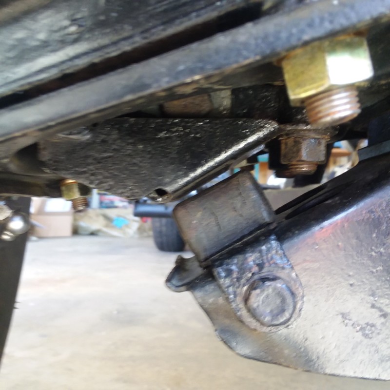

Hope these pics help a bit..I measured the frame height just behind the spring plate on both sides and the right side is 7" and the left side (no gap side) is 7 1/4". Don't know that maybe the rebound stop resting on the bracket is affecting that measurement a bit but if it is, I'm guessing that's how much the stop is resting on the bracket.
The rubber stops don't look like the same thickness but they are.

Since it doesn't have the body on it yet, the suspension will be at or close to the limit of its travel. When you have more weight on it, you'll compress the springs more and can then evaluate it a little better. I don't think you can make conclusions from what you see now.
Have the bushings been tightened? It's best to wait until there is full weight on the suspension before tightening them. That alone might account for part of the difference.

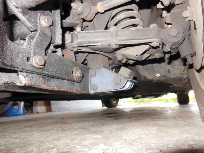

I thought a little more about your suspension settling problem and think the problem is in the adjustment of trunnions or upper and lower A arms. I took a picture of a tr3 that is an all-weather driver and setting on the tires and is often road- hard and hung up wet. There is about an inch or more of openness between the rubber and the fixed point. Your car is a tr4 and uses a different trunnion and upper A arms, but the cars are a lot the same at those points. You might try loosening things up some and bouncing the car by hand if you are concerned about have the correct parts in place. I think the suspension should relax some. The body is not that heavy and should not make a big difference.

Thank you for taking the time to take the pic and posting. The nuts on the pivot points are slack, and I verified the shocks are the correct size. I hadn't, however, considered the trunnion(s) as being adjustable but I remember now they are, to a point, depending on how far up they are screwed onto the vertical link. I'm not finding any specific specs on that other than that they move freely and I tried to give both sides the same number of turns to the point of the top seal making good contacts. Gonna be a major pain in the butt to do but I guess it's come down to rechecking them.
I realize everything is going to settle, I get that, but if I don't get some space on the side that's already resting on the bumper the spring pressure will keep that from happening on that side (?) which is why I'm being so anal about this thing.
