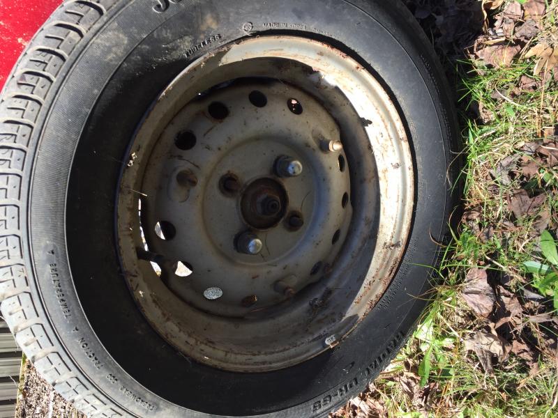

Pulling apart a TR6 and I noticed that this wheel was different from the others. I’m assuming that the 3 posts are for a hubcap?

Yes it’s either a 250 rim or from a 69 TR6.

Thanks, I was hoping someone knew the answer...now, what to do with it.

Find the rest of the 250!
69 TR6 wheel. 250 wheels did not have nipple extension but Rostyle hubcaps will fit on that wheel. I have a couple of sets. Plan to use the wider 69 wheel and rostyles on this next 250 rebuild.

BTW- a TR3/4 hubcap will work on that wheel if you wanted to do something a little different
