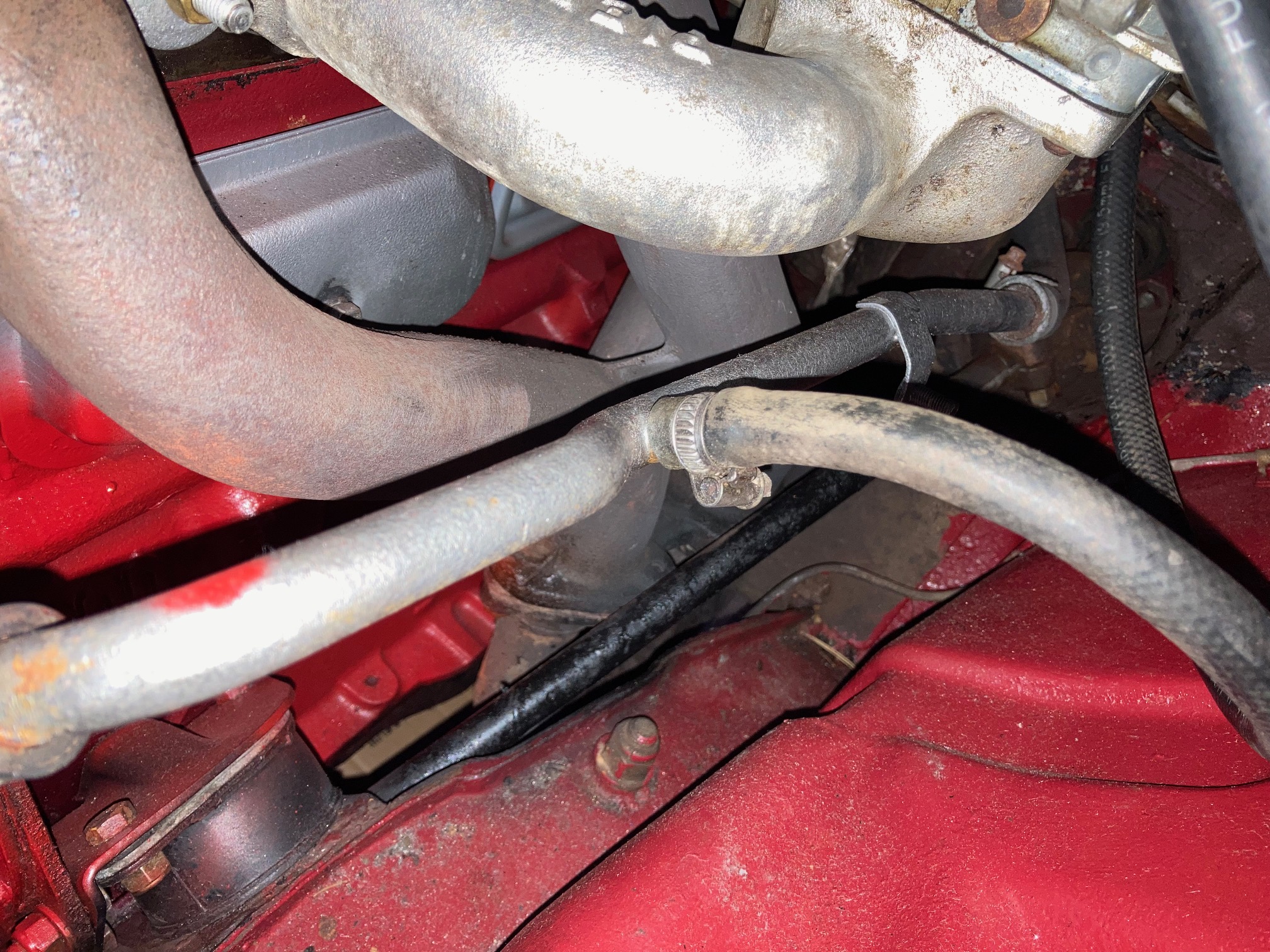

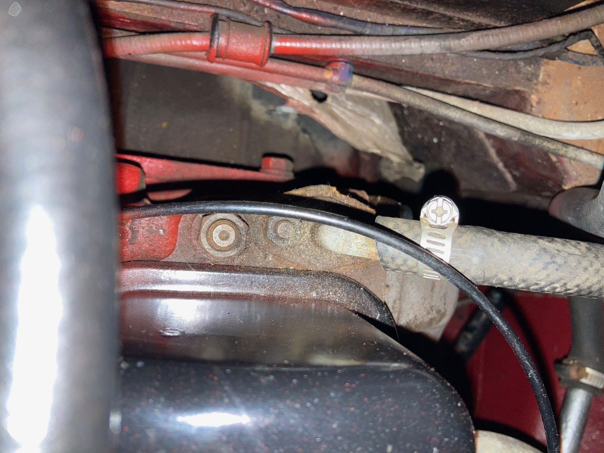

This is the view of the rear of the cyl head and its "plumbing" in the left photo. The right is of where the water line attaches to the heater pipe. No Zenith's so perhaps I can blank out the fitting?

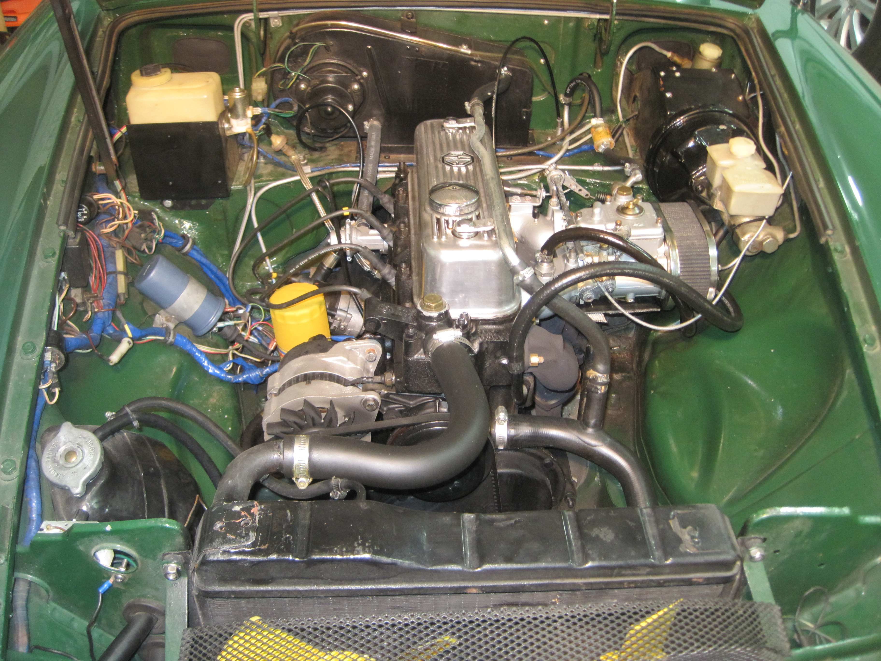

Joe Reed
Yes. The way I like to do it is to remove the fitting, trace the outline and the location of the mounting holes on a piece of scrap metal of similar thickness, cut it to shape and drill the holes - then cut a gasket to fit and reattach with the original screws. Then run the heater hose directly from the radiator hose to the heater...or use the heater pipe like mine:

Celtic 77
Thanks for the info... ANOTHER PROJECT !!!
