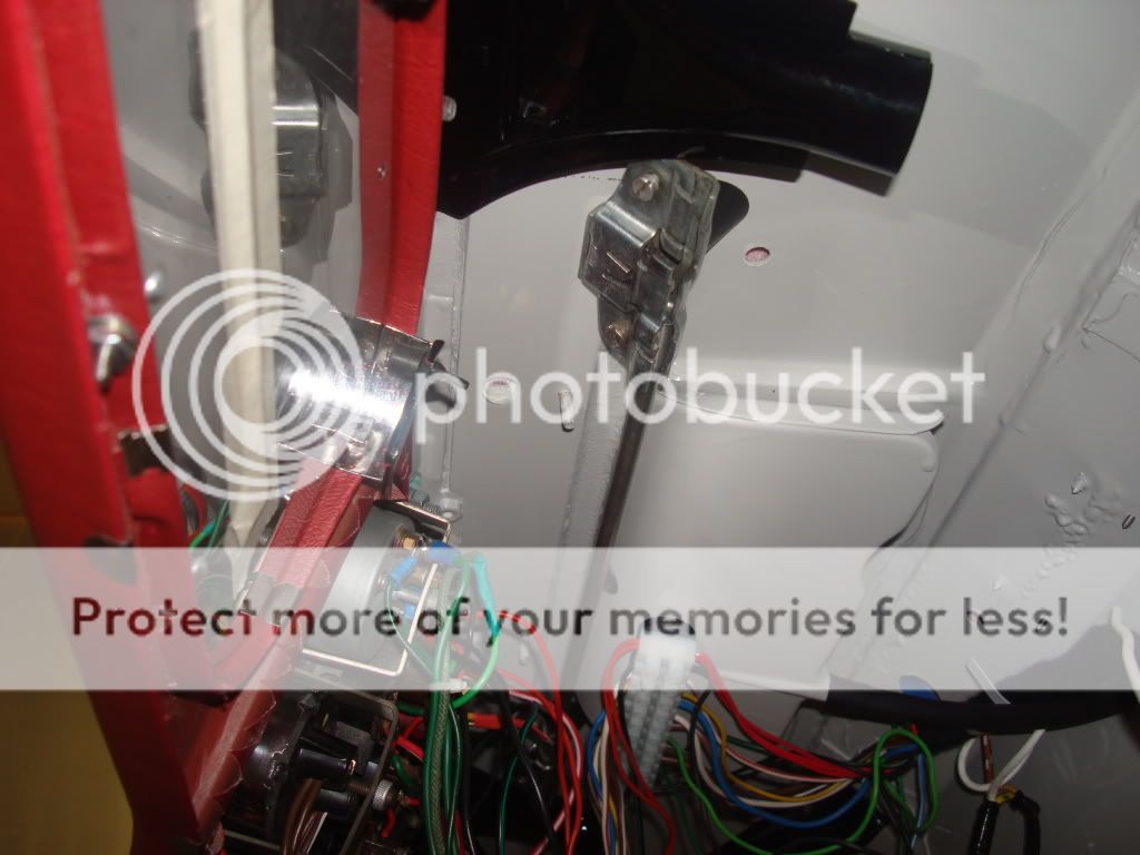

Many of the components those blunt wires go to have "pigtails", or short runs of wire coming out of the component that also end in a blunt connector. you join them together with those rubber covered barrel connectors. Single barrel will join 2 wires, the double barrel ones will join up to 4.

Thanks for your reply and the photo. Very helpful.
