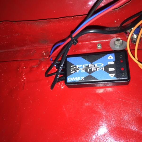

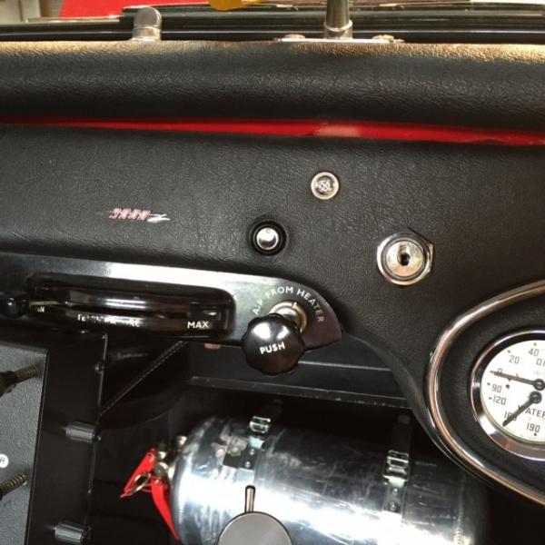

Just to close the loop, I went for a OMEX "Speed System" which is a rev limiter and shift light comb. I've used their products in the past and had been pleased with them.
You can program the hard limiter in which a soft limiter comes in 200 rpm before and the shift light point.
It installed neatly out of the way under the dash.
It has an LED shift light, now normally I wouldn't cut a hole in the dash but there was a hole already from a redundant cold enrichment cable. It's fairly discrete, yet visible.
Just a little insurance to stop an over rev (under load) for about ÂŁ110.
