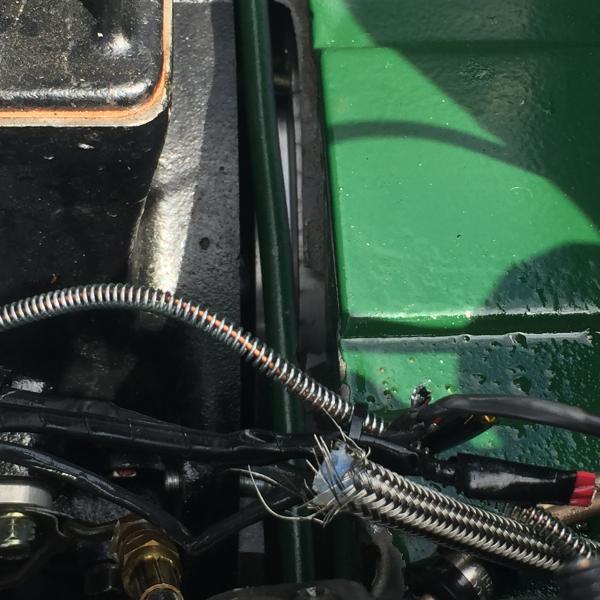

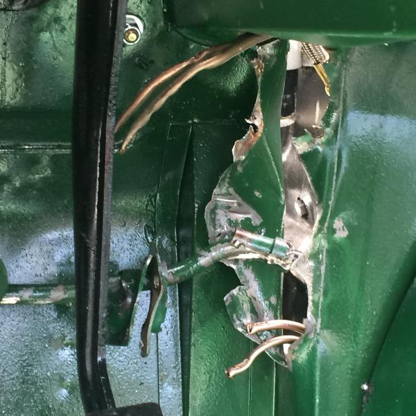

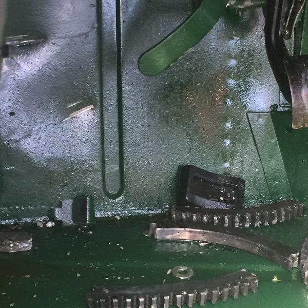

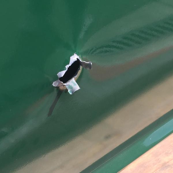

Pat Galvin and I went to the Kas Kastner cup races last Sunday. As we were going thru the pits we saw a green TR4 with what looked like a 50 Caliber bullet hole thru the fender. (third photo)
Turns out the guy was running 6000 rpm's when the ring gear on the flywheel came off. The bits went thru the bell housing fire wall etc. The driver suffered no injuries.
IMG_3607.jpg IMG_3608.jpg Lots of damage the the firewall
IMG_3606.jpg IMG_3609.jpgThe clutch pedal is bent up out of the shot to the left.

OMG! Steve, the first time I looked at it I thought I was looking under the bonnet. It's where the accelerator pedal used to be! That driver was so lucky he needed to go buy a lottery ticket..
