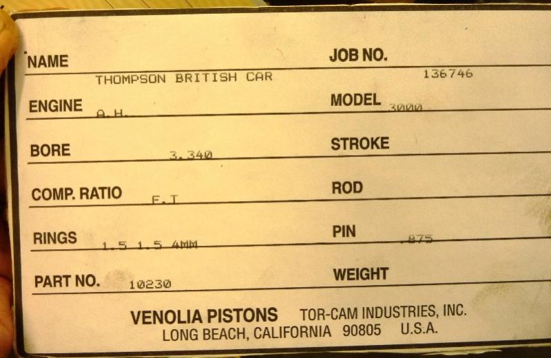

Mine is .060" overbore - the max standard bore. Here's the build sheet for the pistons.
This size with stock stroke of 3.5" gives displacement of 183.9 cu in.

Danny - can you post a build sheet?
