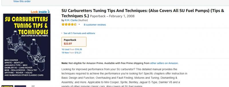

I had the same problem until I rebuilt the carbs - IMO, it's caused by air leaking past the butterfly shaft bushes. Most important is to fit new plastic bushes around the butterfly shafts.
Rebuilding HD8s is easy. I also fitted new needles, jet diaphragms and slow-running screw washers.
I'd get some extra plastic bushes as they're easy to bung up on install.
This invaluable book has step-by-step instructions on the above:
One of my favorite books!
