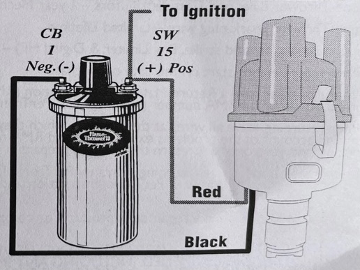

Thank you new friends of British Car Forum. I understand those who stick with the original ignition system. And, why others have opted for the Pertronix. Since my first experience in this car was a sudden closure of points that left me stranded, I opted for the newer technology. I am not going to make a u-turn now. There were good take-away points from all points of view.

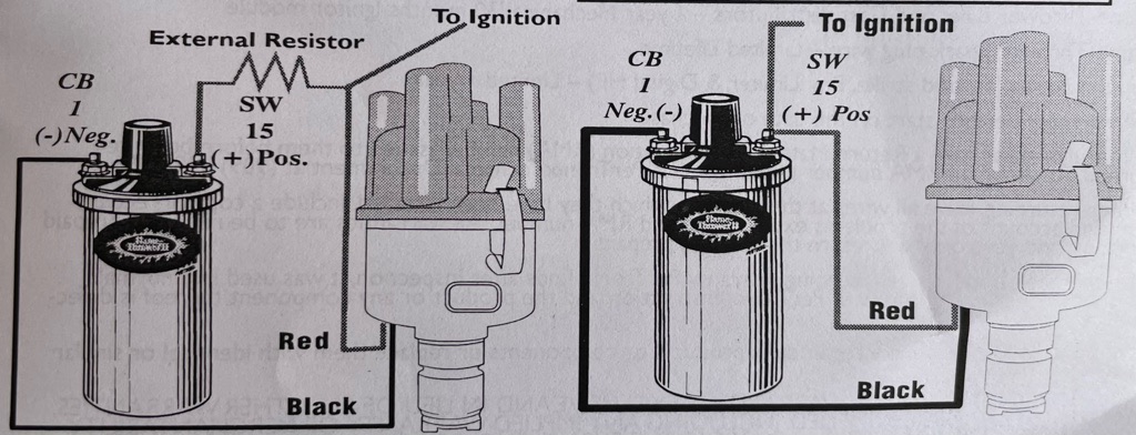

I received all the Pertonix parts today. What is confusing is that my battery negative is hooked up to the frame - hence I take it this is a negative ground system. However, the wire from the positive fuse box was connected to the original Lucas coil on the negative terminal. The wire from the positive terminal on the coil was connected to the distributor. The seems wrong. The insert on the Pertronix Flame Thrower Coil shows the opposite, and I am going with that for now.

Negative ground conversion is common on these cars.
Yes, connect the coil as shown in the figures you posted. If you are using the old coil, and it doesn't have a ballast resistor, you won't need one with the Pertronix. If everything works, the problem almost certainly was the capacitor. If not, it's most likely to be the coil.

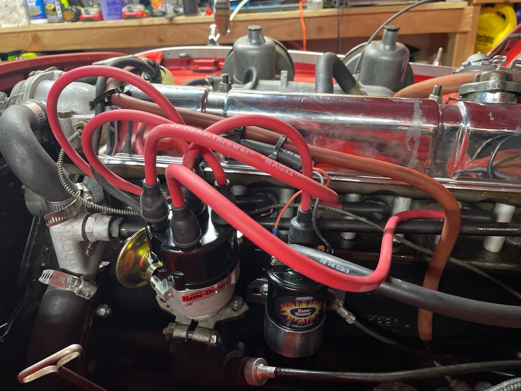

Mission accomplished. This Triumph TR3A runs sweeter than ever. The engine literally hums on the highway at 70mph or the city at start & stop speeds.... No faltering, no floundering at all RPMs, and great compression. An amazing difference.
For those interested:
Items added:
* Pertronix Flame Thrower distributor Model D176600 on Amazon for $174.99
* Pertronix 40511 Flame Thrower 40,000 Volt 3.0 ohm Coil on Amazon for $49.00.
With a new 12gauge wire from the car's ignition to the new coil.
* Pertronix 804412 Flame Thrower Red 8mm Spark Plug Wire on Amazon for $48.99
* NGK BPR6ES plugs (I would have preferred the BP6ES for the extra voltage because I do not need a resistor and do not want a radio. But they were not in stock and I did not want to wait). I kept the plugs gapped at 0.025 and did not have to add an extra 0.005 to 0.007.
* Solid State Electric Fuel Pump by Facet, Part# 377-420 on Moss Motors for $109.99. This was placed between the fuel tank and the original mechanical pump. Preceded by a fuel filter between the tank and electric pump. I set it on a neoprene rubber base to make the clicking noise very negligible.
* New rubber gas line from the tank replacing all the old lines.
New toy:
* An Innova digital timing light that sets the advance to 4deg and it also registers the RPMs on the display; at CarQuest for $104. Very easy to use. With the display set to 4 deg, just turn the distributor and bring the pully mark to the pointer. No guesswork.
I did not want to make a u-turn from the decision to go electronic; nevertheless, I did not turn a deaf ear to the advice. I will keep the distributor, get a replacement coil, condenser, cap & wires. I will keep them in a small box. The tools needed for switching back to the point system are simple, and consist of a 7/16" wrench, a flathead screw driver, and a 0.015 feeler for the points. Finding TDC using the finger over the plug hole was easy. Now that I know how to exchange distributors, if there is a next time, it will be a cakewalk. I could do it on the side of the road.
