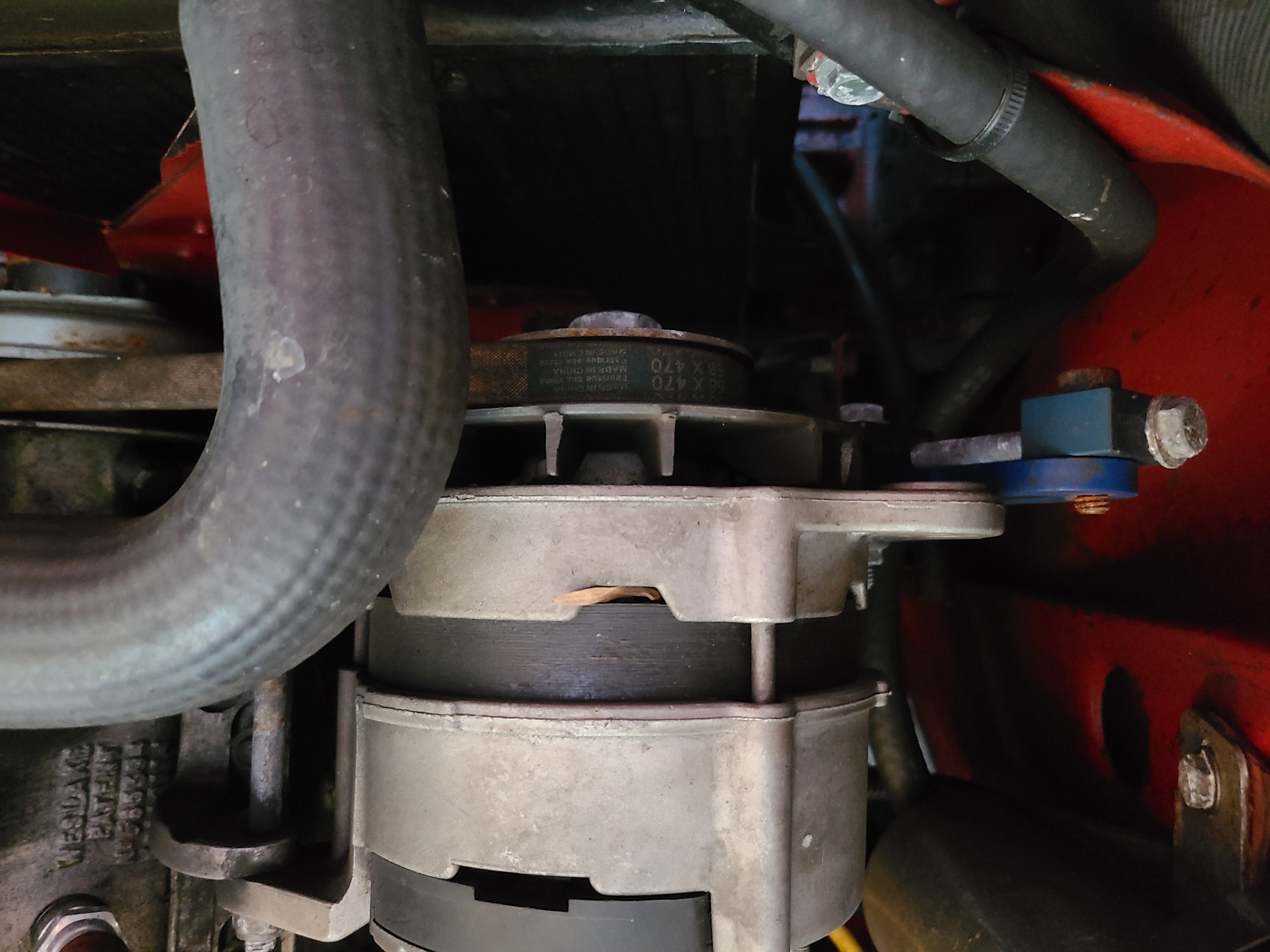

Michael Oritt
I installed a Balmar Belt Buddy--an adjustment arm with adjustment done via an easily-reached bolt. It eliminates the need to apply "leverage" on the generator/alternator which usually takes three hands and tends to push it out of alignment. The BB makes tightening the belt a piece of cake. The adjustment arm and bolt are the blue anodized pieces in the attached shot.
