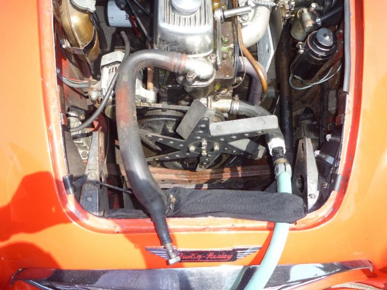

steveg
My homemade setup - radiator off and thermostat removed:
Combination of 1" pvc union with hose shutoff:
attachment.php
attachment.php
I used the Healey hoses and an old stocking to see what would turn up in the net.
