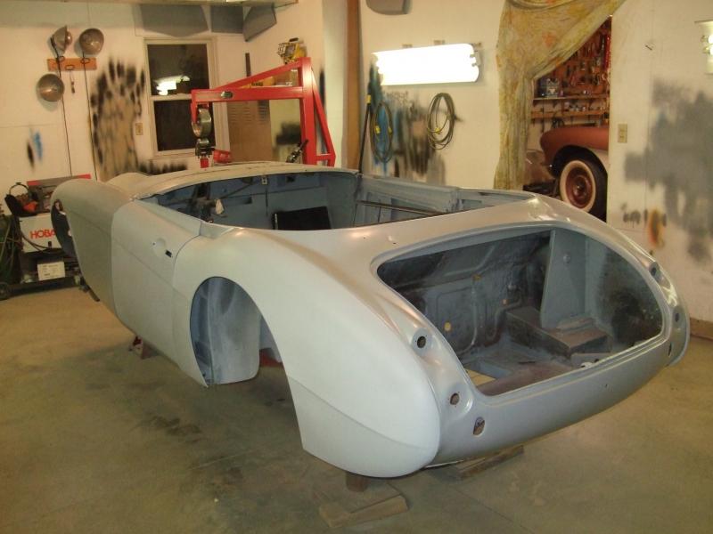

vette
I found a pic that shows where I drilled the hole. You can see it just inside the left rear wheel opening at the rear of the sill box. When I was finished spraying and I felt it had enough time to dry I plugged that whole with a regular black rubber hole plug. just popped in.
