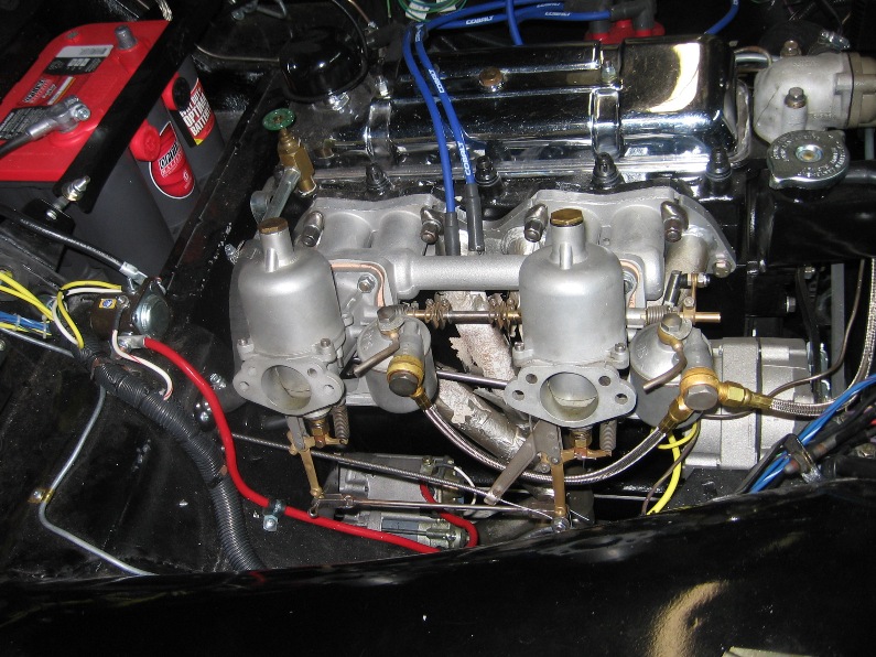

Art, two questions, where did you get your steel braided line and are your bowl lids on backwards?
There are two types of float bowl lids for the H6 carbs. The later type that you have which uses rubber hoses and steel tubes, and the earlier type like mine which uses the braided lines with the banjo fittings. I don't know exactly when the changeover occurred, but since your commission number is lower then my TS23677L, you don't have the original lids. Just for the heck of it, I looked at the Moss site and original SU early lids are available at the princely sum of $79.99 each. Funny, but only the rear later type lid (with one tube) is available from Moss.

Art, I have the correct lids for both my 2 and my 3, all the documentation I've seen the banjo fittings are pointed towards the engine not the air cleaners. The change over to push on fittings is ~40,000
martx-5
Yeah, they are on backwards, but with the headers that I put on, I wanted to keep the fuel line away from the heat as much as possible. I also wanted easy access to the fitting going into the front banjo.. If the car sits for a long period of time, sometimes the gas goes flat (even with Sta-Bil) so I'll add fresh gas, remove the inlet into the banjo and then pump out some of the stale gas into a small container using the hand lever on the fuel pump. It's usually just what's in the lines, maybe a pint at the most. I go through this after every winter. I suppose Triumph had a reason to put them the other way, but I don't know what it is.

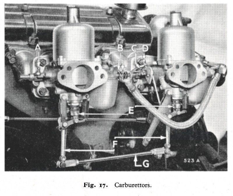

Then have a look at this.

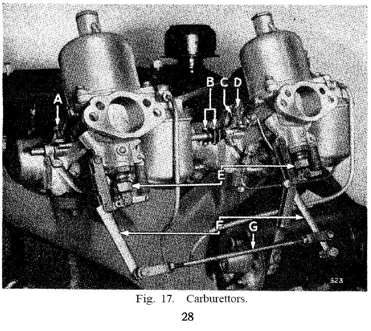

PS, here's the earlier arrangement, from the previous edition, showing the TR2 carbs and their fuel line arrangement:
Fig%2017%202nd%20edition.jpg~original

Those are just the photos from the Driver's Instruction book (later known as "Practical Hints for the Maintenance of the Triumph T.R.3" but the same part number). I suggest to every TR owner that they get a copy of the edition suitable for their car's vintage, as it contains a lot of information that is not found (or is flat wrong) in other places.
The first one (with the flex lines under the carbs) is from the 3rd edition (but is the same as the 4th edition); while the other one with the hard lines behind the domes is from the 2nd edition.
