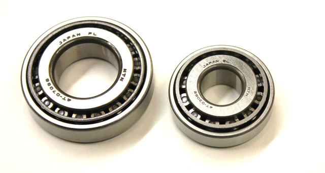

Does anyone have an English Ford out there? I am desperately trying to find a company in the states to buy the bearings from Small Spares is expensive and the shipping is out of this country not to mention the exchange rate.

A little googling found this:
from which it seems like what you want is
Timken 07098-07205 (inner) & 03062-03162 (outer)
Googling the first number (just the first hit)
Making me think they aren't cheap anywhere.
