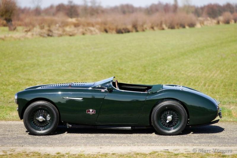

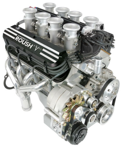

Don't think of it as selling the Healey's soul or going to the "dark-side"... think of it as a sprinkle of Yankee magic to turn the charming British roadster into a hooligan (potentially). I can report that my car will never be "smoked" by a Civic or a Cayman for that matter. Actually most gear heads are stunned a bit by the looks of the Healey so you'll get them of the line every time... always driving responsibly of course. Also, my Chevy/Ford drivetrain is very shop/parts store friendly.
I'm jesting a bit. I'd never swap out an original drivetrain (or I'd keep it in a crate). If you seek to upgrade the stout A90... There are examples of those intrepid individuals who make the best of the torquey little devil:
https://www.britishracecar.com/MichaelBartell-Healey-100M.htm
https://www.britishracecar.com/BillThumel-Healey-100.htm
