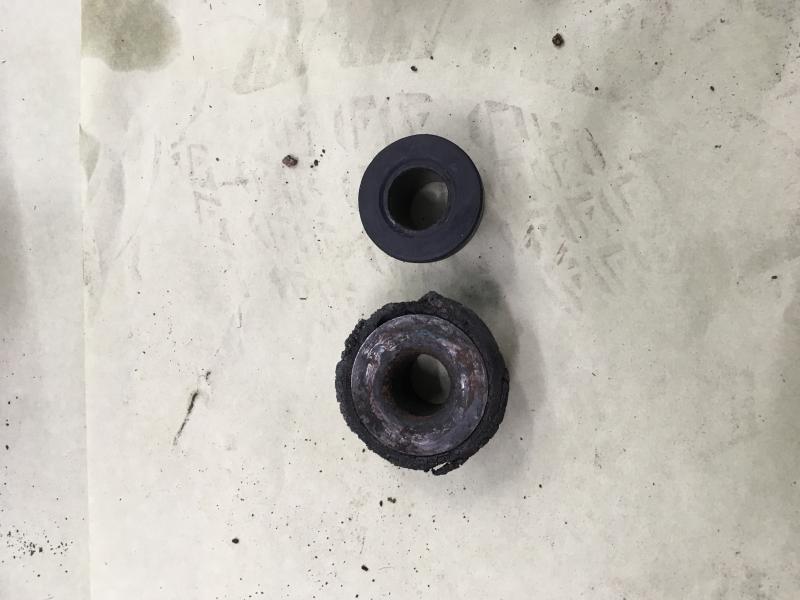

there was a new set of inner lower a-arm bushings in the box. all numbers match what they should. but the old bushings i took out have a wide flange to the outside and the new bushings from Moss do not. Assuming someone has figured out the wide flange is not necc. Thoughts? see pic.

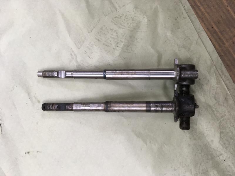

second, the PO must have bought a new swivel pin kit from someone. Not sure who but i did notice a couple of differences from the original. one is that kit came with o-rings in place of the cork ring that goes at the bottom of the swivel pin. again thoughts?
next i also noticed the new swival pins do not use a castle nut at the top of the pin but use a ny-loc nut. again thoughts?
see pic below: other than that the swivel pins look identical.
Thanks
Yeah, the new bushings have not the wider flange for many years. They seem to work OK. Same with the O-ring and castellated nut; the new setup works fine.
While you're at it, consider getting Torrington top bearings in lieu of the stock bronze bushings; decreases steering effort somewhat.
