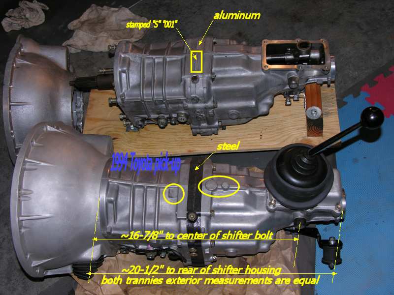

PeterK
+1 on HVDA: Installed easily by me alone, no permanent mods so can I switch to J-type if I wanted (and if I had one). No cutting bending any mods to original stuff. Works flawlessly. If you have a modern car with a 5 speed, it's the same, smooth, rev-reducer.
The two kits I have:
