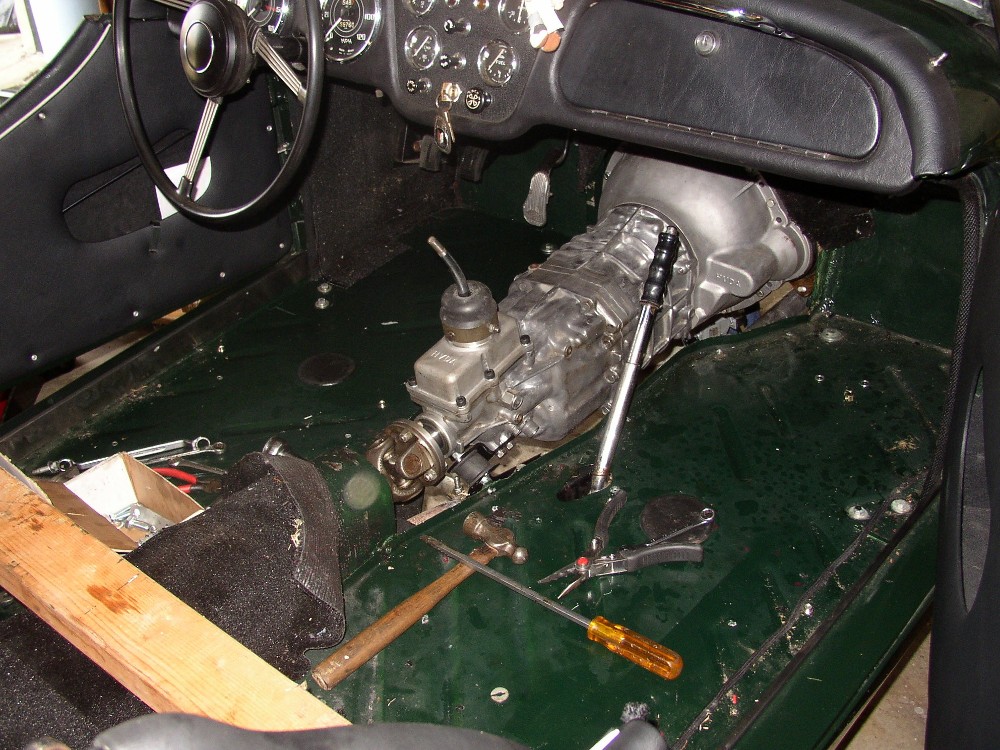

Here is one picture..I'm such a newbee

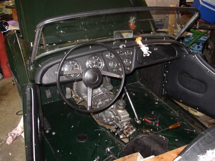

another angle for you...

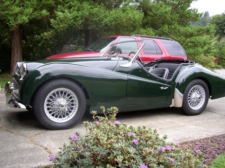

My baby..here in all her glory.
