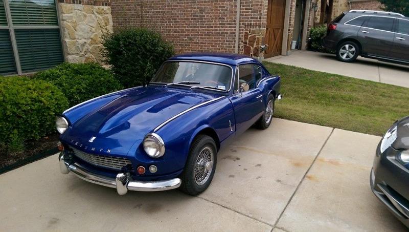

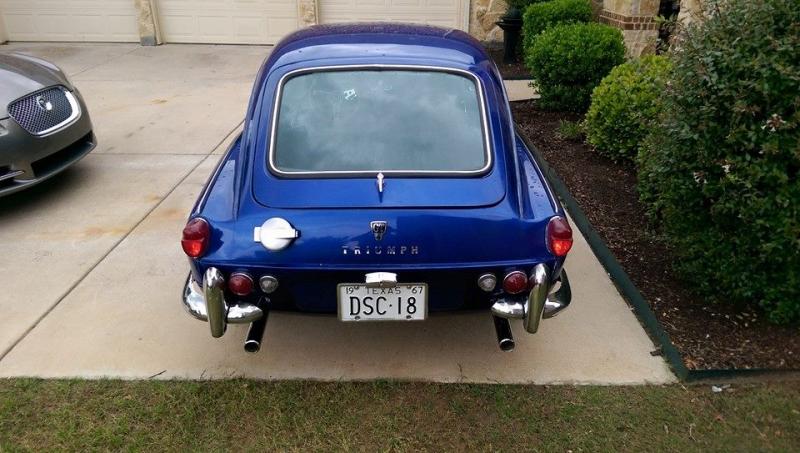

After 3-4 years, (and the State of Texas forcing our hand a bit), we're finally finishing up the GT6. After getting it to run, pass inspection, and registered for another year, since we had to get it running to get it inspected, finally convinced my wife to let me finish colorsanding the paint and reassembling everything rather than just waiting and repainting the whole thing (which I was not motivated to do, since I was sure most of it was going to be fine anyway.)
There are some spots I'm not happy with, and the sills and hood will probably get resprayed again in the future (maybe another 2 or 3 years) I think it looks darned good compared to the bucket of parts we started with.

Well done Rich. Do you have the chrome strips that fit on the body seams under the doors. They do collect water, but most of these cars don't see much water any more. I have a pair somewhere if you are so inclined. Yours looks great, you should be proud.
Wayne
dklawson
That's looking very good! Congratulations on the progress.

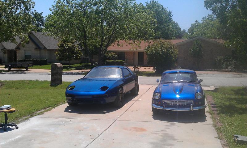

Looks great...What was the Blue you painted it.....I like it..
R
Richter12x2
It's a Mazda RX8 color called Aurora Blue. I'd recommend against it, though, actually.
The Aurora Blue paint uses an expensive toner, and runs about $800 a gallon just for the paint. (Not counting all the chemicals to reduce it and spray it)
The other car in the picture I painted using a Porsche color called "Nachtblau Metallic" and added some blue pearl to the clear. I used too much blue pearl, but the paint was $150 a gallon and the pearl was $15, and you just mix it in with the clear. The lesson I learned here by the way is, if you want MORE pearl effect, don't add more pearl to the clear, just shoot extra coats of clear until you get the pearl level you want, then swap with regular clear and coat it. Adding too much pearl to the clear will end up looking cloudy and mottled if you don't spray it just perfect (and I sure can't spray it just perfect).
But they came out so close to each other, you'd be hard pressed to tell they're not the same color in the sun. The pearl one just darkens up a lot when the light's not on it.

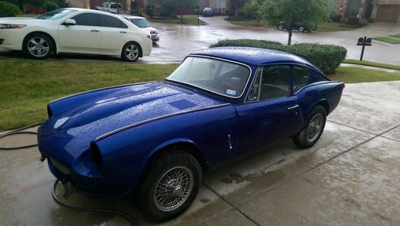

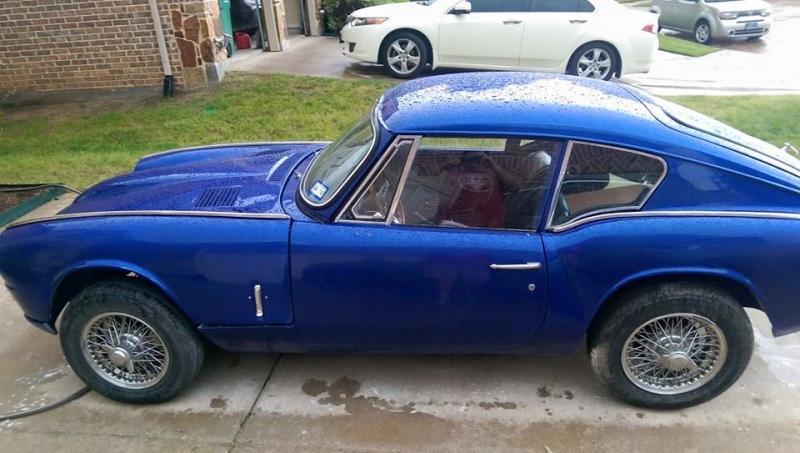

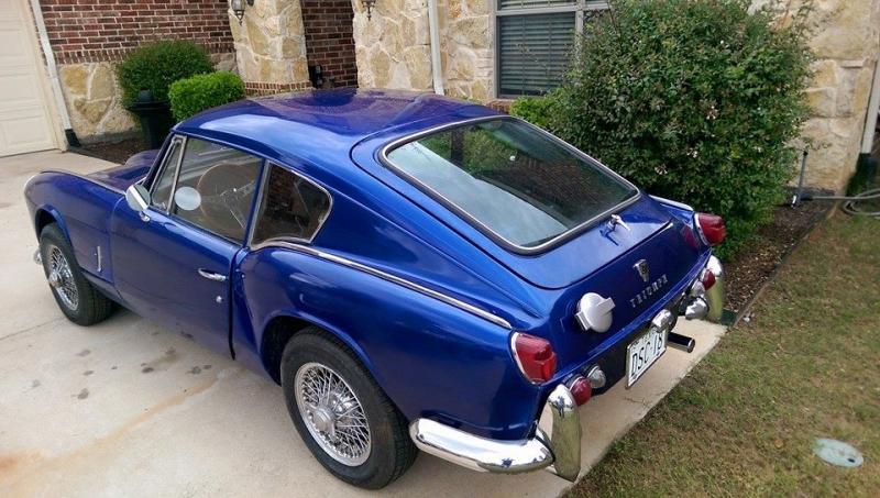

Just finished taking a few more complete pictures to update my classic car insurance, so I thought I'd share them here as well. Mostly together, just a few holdouts, like the trim ring on the passenger headlight doesn't want to snap on, and one of the rings on the passenger turn signal as well. The driver's turn signal bulb doesn't want to flash correctly either, so it just needs cleaning up.
Also it pulls to the left when you step hard on the brakes, so I'm thinking (hoping) my rear brakes are out of adjustment. I don't remember ever setting them after putting it all back together, so hopefully that's it. Hopefully that'll tighten up the ebrake cable as well, if not I can tighten it up while I'm down there. The brakes don't seem to want to lock up, so they may still need to be bled some more, but I'm not losing any fluid at all. They stop, but not as well as they probably should.
Looks like we're going to have good weather soon, so planning to get out to the Pate swap meet on Saturday, and then take the Triumph out to the ABCDE at White Rock park on Sunday, for the first show in public.
