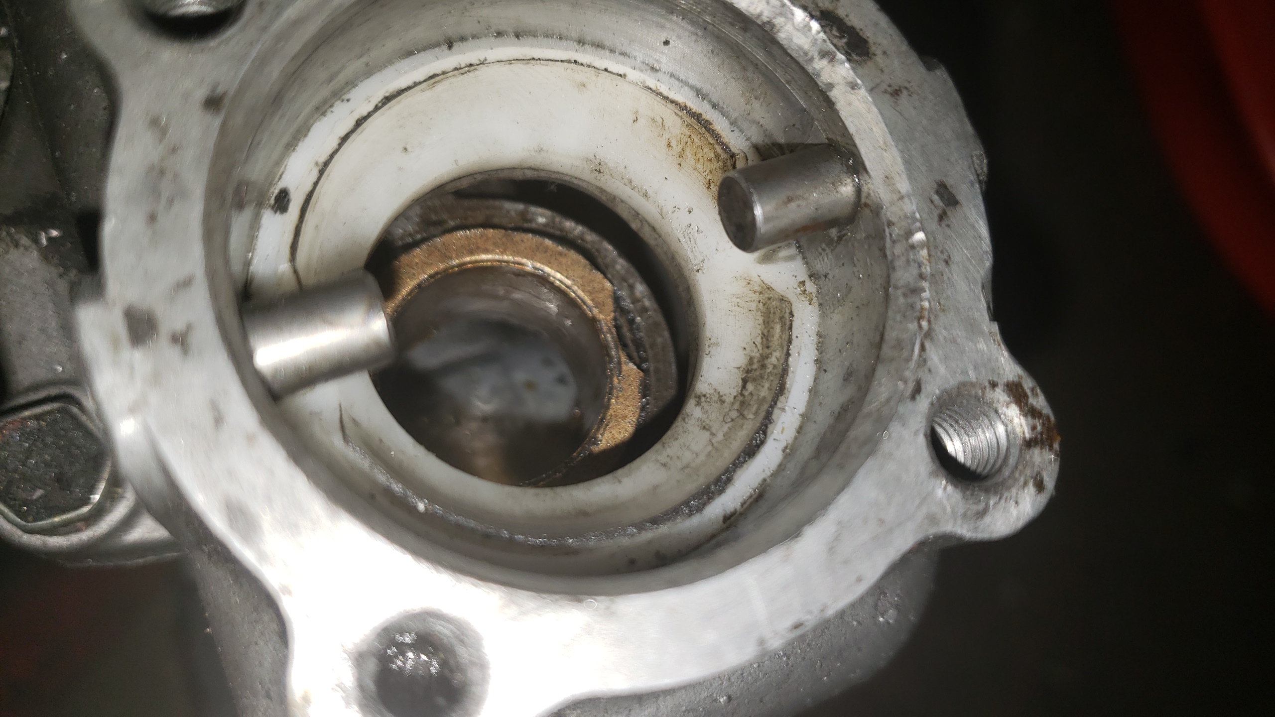

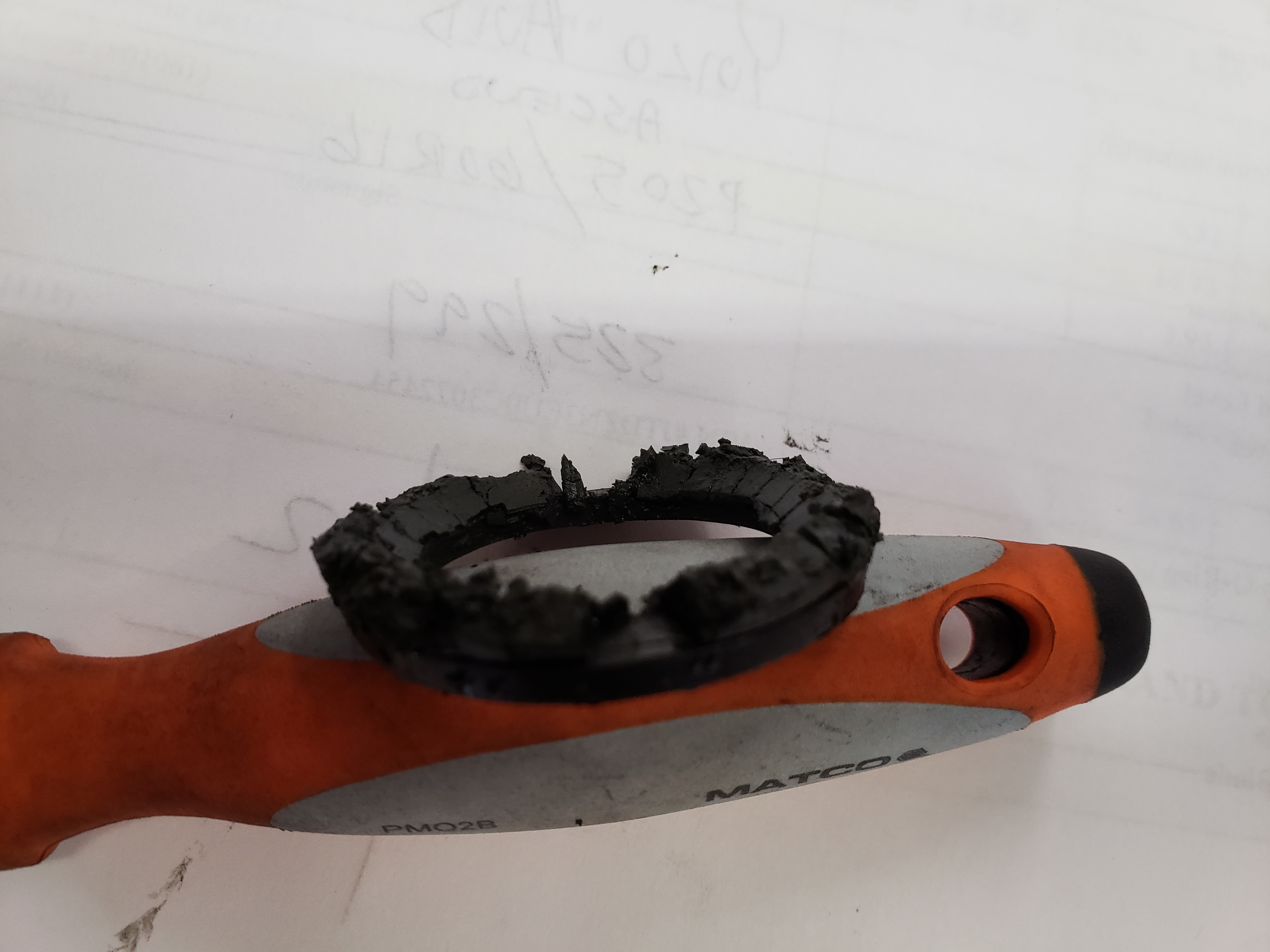

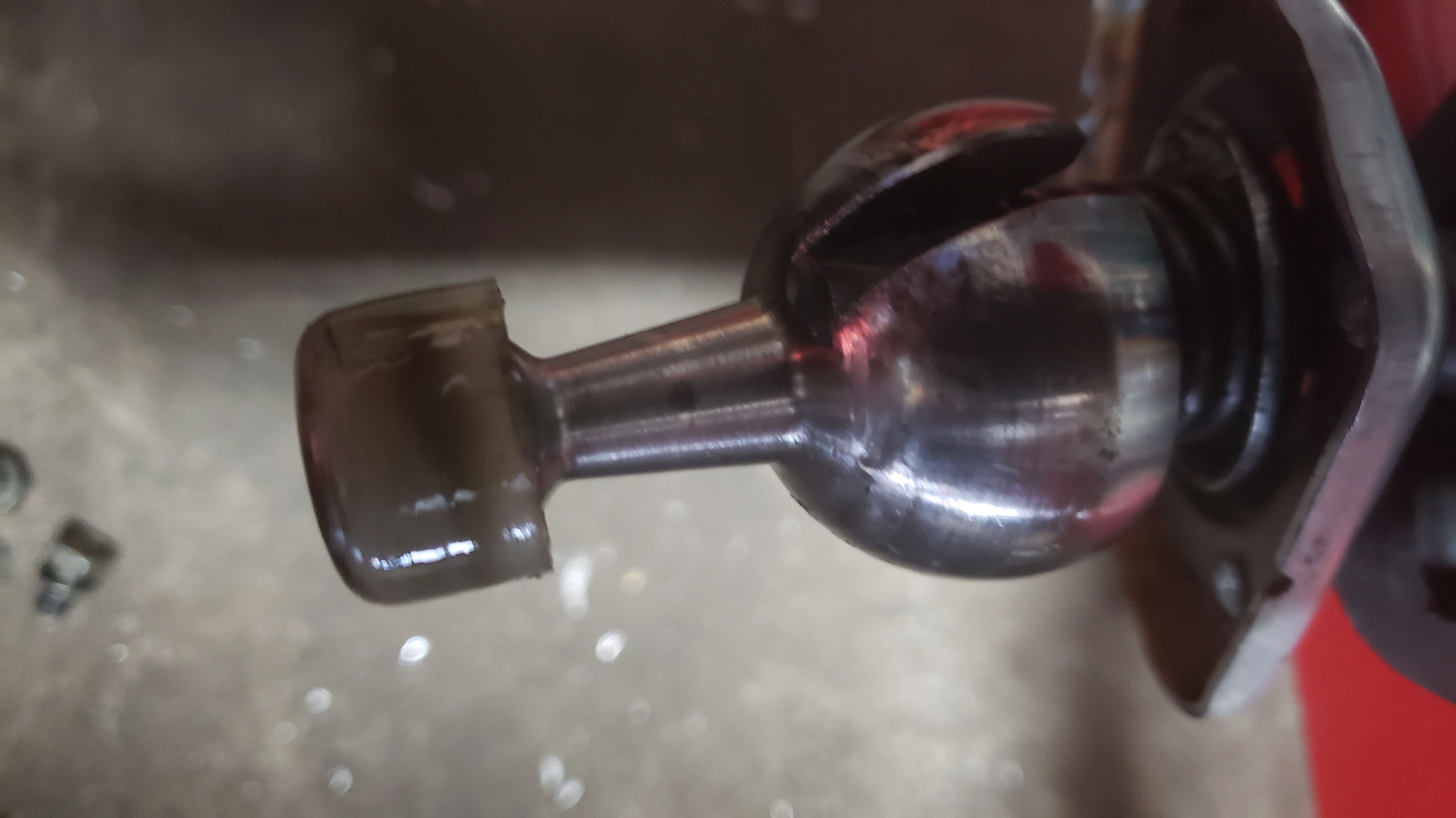

First pic is a worn-out shifter seat (located in shift tower under the large ball in middle of shift lever).
Second pic is what I beleive is a Marlin Crawler one-piece shift lever seat. It is made of a material much harder than the stock piece.
Third is the shifter "cup" that snaps onto the small ball at the bottom of shift lever. In pic two, you can see the receiver at top of "dogleg" that is attached to the internal shift selector rod.

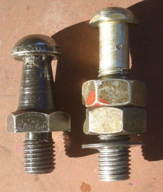

My pivot stud was new too, but I needed having to put 1/4” thick washer under it to get it to work properly. You should not have to change the slave cylinder to another size. Where is the throw out bearing shaft position coming out of the bellhousing hole?
steveg
I have an early Smitty setup. At the time I needed to extend the pivot bolt beyond what the OEM Toyota would do with shims. Took another Japanese metric bolt and turned the end down to a mushroom in my electric drill (no lathe). This has worked fine for 14 years.
The geometry changes depending on which clutch you have. It's relatively easy to mount the bell housing to the engine sans transmission. Then you can verify the operation before installing the trans. The BJ8 clutch (if that's what you have) is thinner than the earlier coil spring clutches. So a combination of longer stud and adjusted slave pushrod is necessary to get the correct geometry. I made a temporary adjustable pushrod out of a piece of tubing and some 10-24 all-thread. When the geometry was correct, used this for length to make a new pushrod out of a piece of steel rod. I may have used a 20d common nail.
