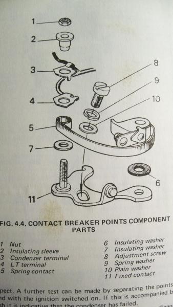

You will have to click on the image...it's from the Haynes manual
Geo Hahn
May look different from that illustration. Sometimes it is just a one-piece thingy - the top and bottom washer with a strap connecting them.
bobhustead
Whatever shape your insulators might have, the power and condenser wires need to be in contact with the spring on the points and neither the spring or wires can touch a ground.
Bob
