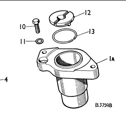

I am currently rebuilding the restored engine for my BJ8 (engine no. 29K / RU / H12115). I have a question here about the attachment of the distributor (type 25D6) to the engine. An adapter coupling plate is specified in the various spare parts lists (number 12 in the attached picture). This plate and the circlip (No 13) are missing.
Could it be that this plate is not required to install the distributor on the later BJ8 models?

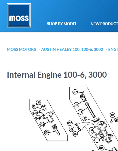

Moss shows those parts for the BJ8 (#130). That plate is necessary to engage the drive dog on the bottom of your distributor. The circlip you should be able to buy by dimension.

Thank you Steve for your reply, but the problem resolved itself. I removed the distributer driving gear again and found that the coupling unit was already mounted on the driving gear and secured with the circlip.
