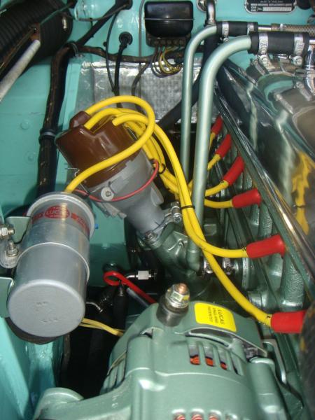

is there a cap sold to fit a stock diz and be able to use the EMI suppression wires?
I use a German made cap on my race motor. I'll look up the part number for you.
