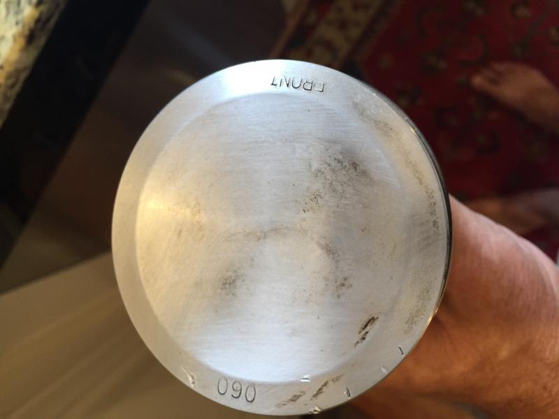

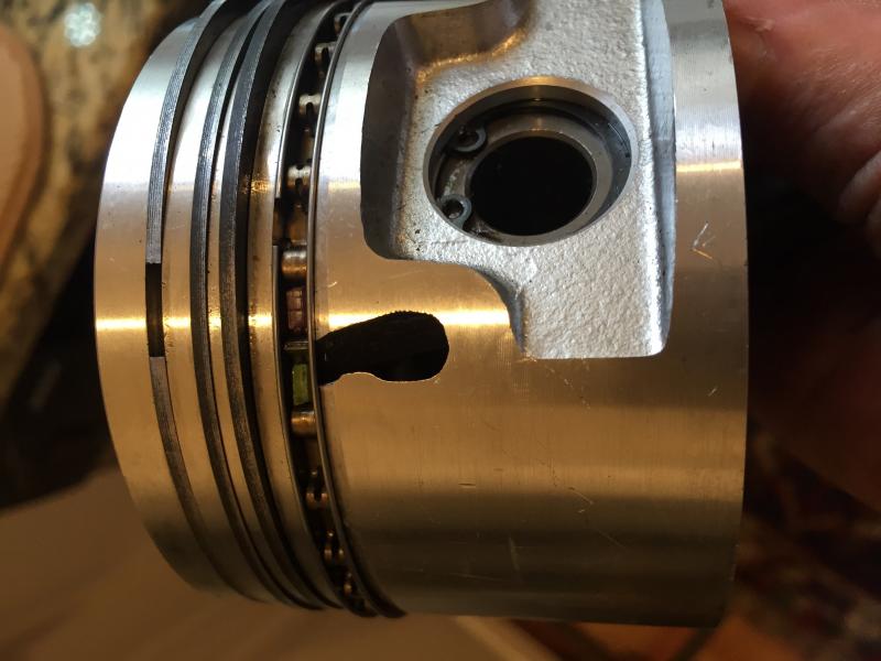

Attached is a picture of my County MGB piston and it does come with Grant rings. My go to engine guy, Hap Waldrop at Acme Speed Shop recommends the Hastings rings as well if for no other reason than for the oil control rings. He's a distributed for Hastings as well as County and really likes the product.
