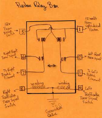

vette
Steve, put your hand on the brake/turnsignal flasher relay on the inner left fender apron then have someone move the trafficator on the steering wheel between left position and right position. If your flasher relay is getting power from the trafficator you should be able to feel the relay click on and off or from one side to the other. Also check for voltage at the # 1 terminal on the relay as per the drawing below. It should be flashing when either one of the turn signals is turned on. Your trafficator may have lost it's ground connection that would keep it from turning on either of the turnsignals. With the trafficator turned right or left if those switches inside the trafficator are working then you should have voltage at terminals # 4 & 8 at the flasher/brake relay.
The contacts in the relay may have failed, especially the ones connected to terminal #1. If you have brake lights but no turn signals then I believe the brake?turnsignal flasher relay is not being thrown to the right or left. See drawing:

vette
John, jumpering terminal 1 to terminal 2 isn't telling you anything worthwhile. All it is doing is taking the voltage at #1 and connecting it to #2. #1 is the blinked power source coming from the little round turnsignal flasher. #2 is the terminal that feed the power out to the left front turn signal. So doing that will make the left front turnsignal blink if the small flasher is working. Which it sounds like in your case that the small round flasher is working or blinking.
So you said that there is no power at #4 and #8. This is the problem because these two terminals are the ones that control the brake/turnsignal relay. So now we have to figure out why there is no voltage at those two terminals. Just for your knowledge if you look at my drawing you will note that #4 is the terminal that pulls the relay for the left turnsignals. This should have a green/blue wire on it and comes from the base of the steering column and ultimately the trafficator left side. Terminal #8 is the terminal that pulls the relay for the right turnsignals and it should have a green/yellow wire on it and it also goes over to the bottom of the steering column. The other wire at the bottom of the steering column is a green wire. This wire should be hot whenever the ignition switch is turned on. Make sure that this green wire is hot when the ignition switch is turned on. Make sure that you probe well into the connectors. the green wire at the bottom of the steering column is sourced from one of two places depending on the year of the Healey. On the early 100/6s this green wire is coming directly from the top 35 amp fuse. On the early 3000s this green wire is coming from a dual connection at the little round turnsignal flasher. the power is brought to the round flasher from the top fuse and then off the same terminal of the round flasher the green wire is then run out to the bottom of the steering box. So this green wire at the bottom of the steering box MUST BE HOT WHEN IGNITION IS ON. And it gets its power from the top 35 amp fuse. If the green wire is hot then the green/blue and the green/yellow wires at the steering box must get hot when the trafficator is pushed one way or the other. The green/blue will get hot when the trafficator is pushed to the left and the green yellow will get hot when the trafficator is pushed to the right. So if green is hot, and green/blue and green/yellow never get hot, then the trafficator is bad or the wires are broken inside the steering column (rather unlikely).
Now, a quick fix. Firstly, jumper the green to the green/blue and the left turnsignals should work. Then jumper the green to the green/yellow and the right turnsignals should work.
If this is the case then you can mount an alternative switch to do what the trafficator is suppose to do. I did this one time when my trafficator was acting up. Buy a 3-way, toggle switch from the parts supply house. This switch will have 3 terminals on it. It can be called an on/off/on switch. I mounted this switch to a small bracket that I made for it and mounted it under the dash to any convenient screw. Disconnect the green wire, the green/blue wire and the green/yellow wire at the bottom of the steering box. Run the green wire to the center terminal of the new switch, the green/blue wire to the left terminal of the new switch and the green/yellow wire to the right terminal of the new switch. Turn the ignition on and the brake/turnsignal relay will work. Job Done. Fix the trafficator later. Cheers.

RAC68
Hi Steve/Vette,
Vette has provided a clear and accurate explanation of the function and wiring of this reasonably complex circuit. Keep in mind that the ground for circuit operation is provided at each bulb and a filament burnout will eliminate ground connection for that leg of the circuit. The ground for relay within the brake/flasher relay is provided only by the units ground with power for the relay provided through terminals #4 or #8.
If I am interpreting your comments correctly, you mentioned that at the base of the steering column, you had power delivered to the green wire as well as power at BOTH green/blue and green/yellow contacts simultaneously. Additionally, you indicated moving the switch from side to side made no difference with both sides remaining powered. This indicates a fault in the trafficator circuit and either a wiring short (not likely) or switch fault.
Also, you indicated although you did have power at the 2 client connectors at the bottom of the column, power was not present at either flasher-relay terminals (4 or 8). If this is correct, you either have 2 wires burned out or non-functioning connectors at the base of the column.
With no power at terminal #4 or #8, the internal relay can not function and the switch will not take place. Additionally, you also indicated that jumping Flasher-relay terminal 1 to terminal 2 allowed the lights on the left side to illuminate and blink. With this result, and knowing your brake lights also function, you have shown that both light circuits have grounds and the flasher-relay's internal contact points are functioning properly.
To check out the relay within the flasher-relay, I would jump terminal 1 to terminal 4 (left) or 8 (right). If the left side signal lights blink when terminal 1 is jumped to terminal 4 and moved to the right side when the jumper is moved from to terminal 8, I would consider the internal relay functioning properly and the full flasher-relay working.
So, we are down to
1. A fault in the trafficator switch (delivering power to both client circuits simultaneously) and
2. NO Power being delivered from either of the client leads at the steering column to the flasher relay.
Again, some of my analysis is based on my interpretation of your presentation of your test results.
