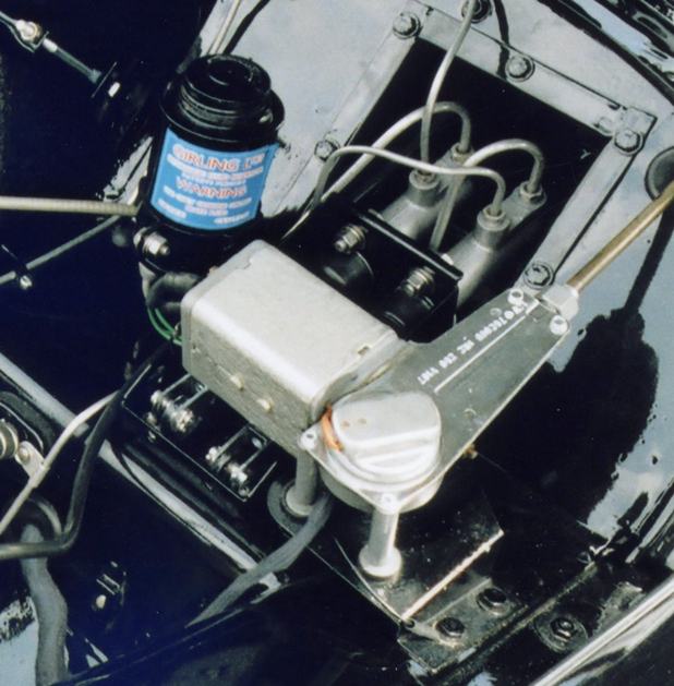

For my 1958 TR3A, I have used silicone brake fluid since 1990, driving city, highway and freeways a little more than 100,000 miles. The braking effect was always like previous fluids and the same as other more convention modern cars. I only once had a problem. That was when I spent a week at an altitude of 10,000 to 12,000 feet during VTR in Colorado in 2001. I think that bubbles emerged from within the fluid with the reduced ambient air pressure at those altitudes. After we bled them, they were fine. I would guess that during the last 18 years, I've changed the silicone fluid about three times. I keep it topped up and that might be equivalent to a full change, as far as fluid volume goes. I never had any issues with silicone fluid related to humidity or water absorption and the lubricating properties have kept all the caliper and brake pistons free and they never rusted or became stuck with rust or crud as they might with other DOT 3 or DOT 4 fluids.
