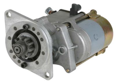

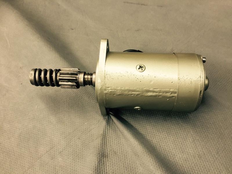

The two pics show a comparison of the starters. The original has a beveled leading edge that engages the ring gear from the transmission side, right? The gear reduction seems to engage the ring gear from the engine side but has a flat edge on the starter shaft gear. I don't have a pic of the ring gear but I believe that the beveled edge is on the transmission side to match up with the original starter.
I'm hoping that someone like Randy Forbes who's installed the gear reduction before will weigh in.
Dale

I believe the gear-reduction starter pinion is fully meshed to the ring gear all the time and engages via an overriding clutch. Therefore the pinion does not move, unlike the original which, on operation, engages forward into the ring gear. Therefore the non-beveled edges on the ring-gear teeth should be toward the front, meshed with the new starter pinion.
Moss refers to the installation as "fairly straightforward", which it would not be if the trans and flywheel had to be removed in order to flop the ring gear. People just bolt these things on.
I have a gear reduction starter, although not Moss it required no change to the ring gear. I can't believe the Moss version would require that either, unless they are totally incompetent.
I think this is a non-issue.
I have installed various gear reduction starters on all my cars. I am not certain about the ring gear on the Ford-engined Ginetta but I know that on the Healey and both Elvas the original ring gears were all "oriented" toward a starter pinion that pulled in from the back whereas the pinion on all of the gear starters engage from the front.
Though it looks like there might not be a perfect mesh because of the lack of bevel on the front edge of the ring gears' teeth I have never experienced a problem with any of them not engaging properly.
I also installed a gear reduction starter on our 64 BJ8. I have experienced no issues, although car has only been started a few dozen time as we are still finishing restoration. Starter works great. In fact my ring gear if I would have used the original starter would probably have to have been replaced as many of the teeth were a little chewed up, the sides facing the tranny. But by using the geared starter I did not have to replace it, as it engages from the engine side. I too was concerned about not having the taper on the engine side of the ring gear but was told not to worry by the vendor.

I installed a gear reduction starter 4 years ago, and did not reverse the ring gear. It works perfectly every time.
These replacement starters are not engaged with the ring gear all the time. That would mean the small gear is spinning with the engine all the time ? They are engaged with the solenoid on top of the starter. They work fine with the ring gear in either direction. If I had to do it again I would switch my ring gear to aid in the meshing of the teeth. Maybe Randy will chime in ?
Below is from Moss Tech. Very nice video.
https://www.youtube.com/watch?v=ITFW2PkqXWw
The above video will help.
You don't have to turn your flywheel around.
The pinion gear only contacts the flywheel when it is at work. The rest of the time it is retracted back.
The teeth on the leading edge of the pinion gear are beveled to mesh as they should with the flywheel.
