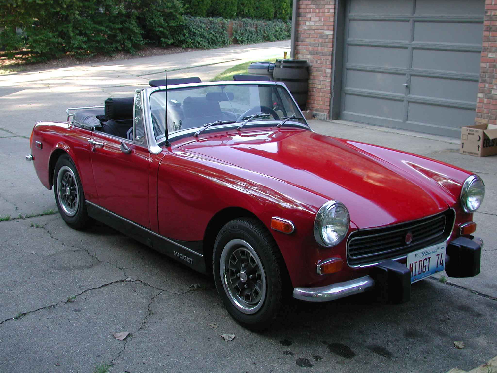

Tony, the wheels are the 'inter year' type as attached.
The manager that investigated said the sales assistant couldn't find 'midget' in the computer to get the specs, so he looked up 'mini' instead, this wouldn't have been as bad if the computer didn't default to the 'new mini!'
Thanks for your thoughts.
Ignore the attachment, phots too big. Anyway, they're the mkI Rostyles
